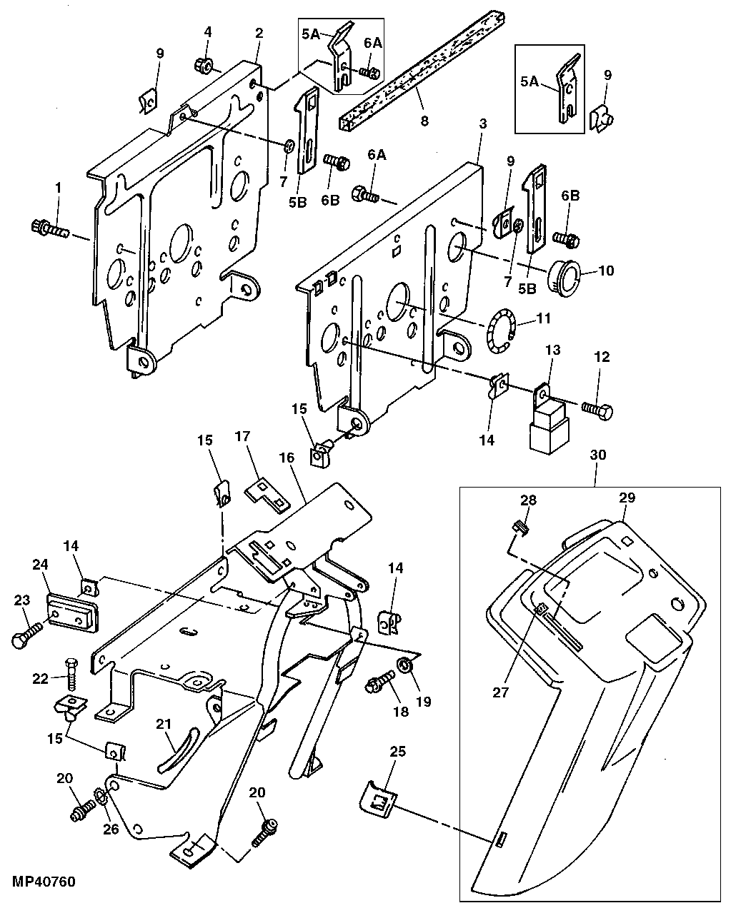

Update on this issue. The mower deck switch seemed to work fine for a couple of trips across the yard however today the deck shut off and when I cycled the switch it briefly kicked in and then nothing since. I looked for the relays you described but didn't find anything forward of the battery. There's a mess of wiring underneath the battery tray so when I get time I'll pull the battery and tray and see if they're under there unless someone can point me to them. Wish I could find a good schematic of that part of the system.
   / JD 285 mower deck clutch #5
bensallen
You can look at the relay and how it is mounted behind the instrument panel (part # AT75769 ) by going to jdparts.com (free registration) and putting in the model # (285) then RELAY under alphabetical listing.
   / JD 285 mower deck clutch #6
From JDparts
I have checked voltage to the plug on the clutch and getting almost 12VDC. Checked resistance on the clutch coil (2.8 Ohms) I'll have to line up some feeler gauges and check the air gap as that seems to be the problem.
