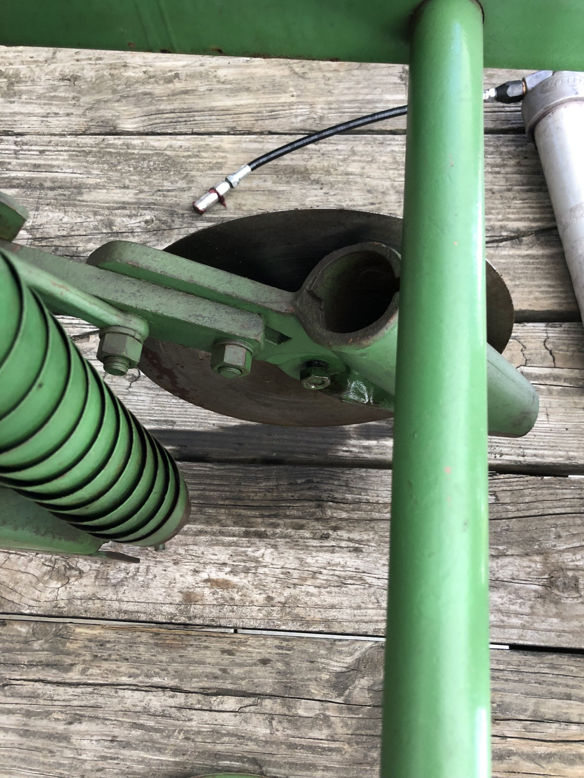

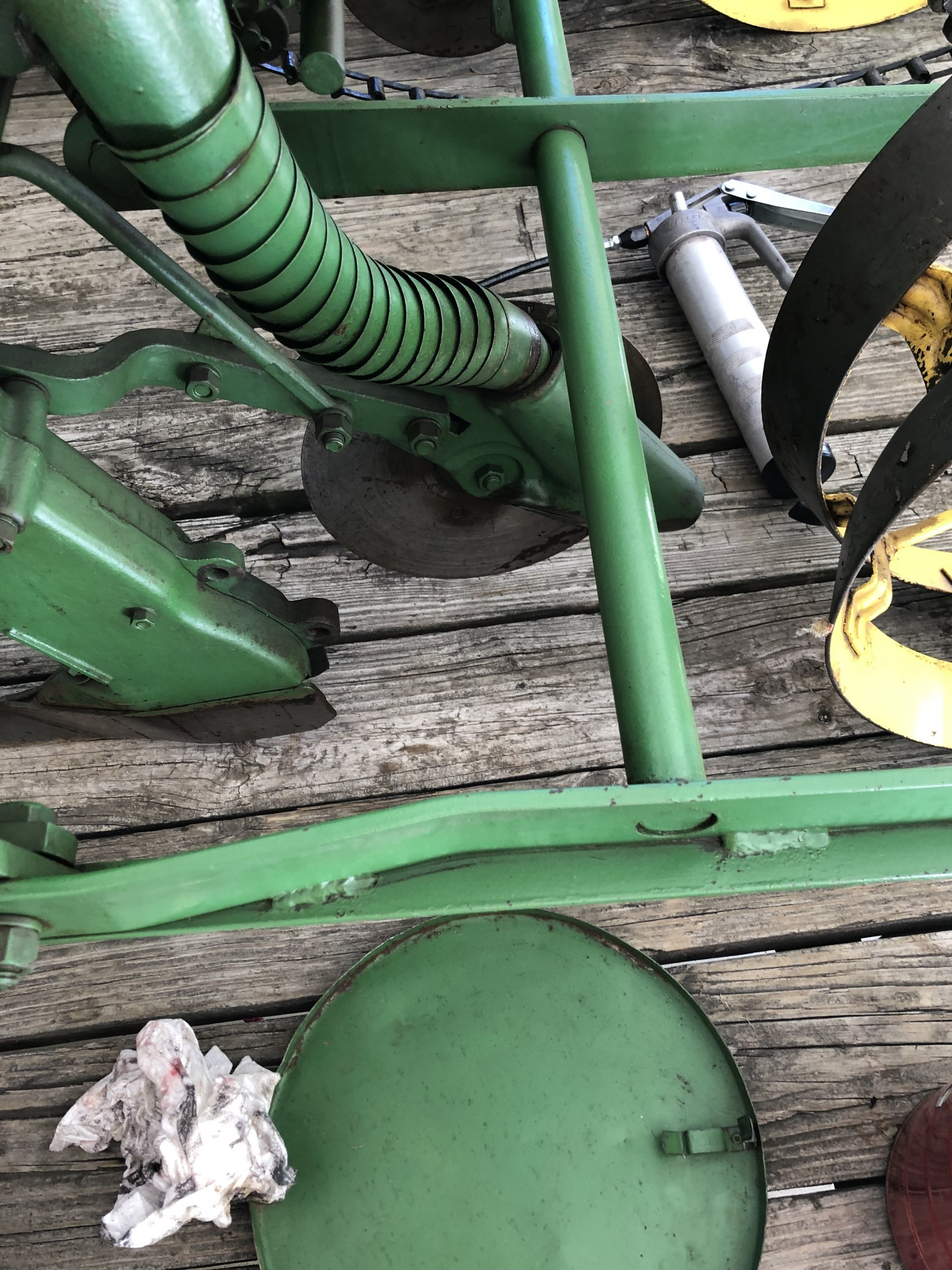

I have jd 246 corn planter fertilizer disk wobbles on both units as it is a 2 row planter jd has no bearings might be able to come up with bearings if can get torn apart it’s a tall order end is riveted shut call 419-522-0758

Might want to check agrisupply or shoupe farm parts and do a search for seed disc or disc coverer. Should be able to find a disc with the bearing already installed.

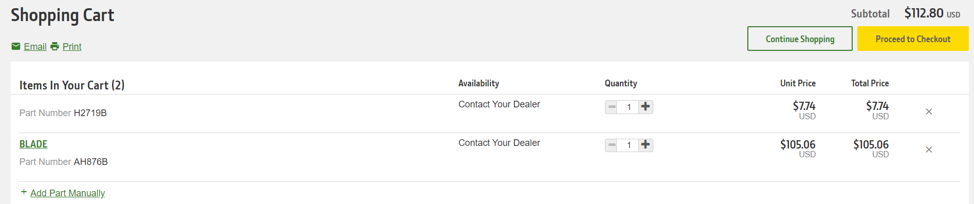

Brg & complete disk assembly with brg still appear in JD parts.

remove the grease fitting and it was a 1/4 allen bolt inside remove lock nut on the other end of bolt need to heat around bolt to unscrew it that come like an assembly disc and bearings
