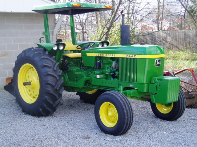

The 2440, like all the Deere's of that era, have an external hydraulic pump just ahead of the engine. It's a noisy pump as far as hydraulic pumps are concerned. The engine itself is loud. I never really understood why, it just is. As you can see in the photo, mine has the ROPS & canopy. Deere put the same sound insulation under the fiberglass "roof" as they used in the SoundGaurd cabs to deaden some of the noise, but they still tend to trap noise rather than deaden it. Back in '79 when I first bought the tractor, one of the very fiirst jobs it did was finishing spring plowing when the Ford 5000 it replaced snapped the crankshaft. I spent 3 straight days plowing. It took a month before my ears quit ringing. The 2440 is the reason why I started wearing headphones while on a tractor.
That picture was taken over a year ago. After nearly 2 seasons on the mower, it isn't quite as pristine.
