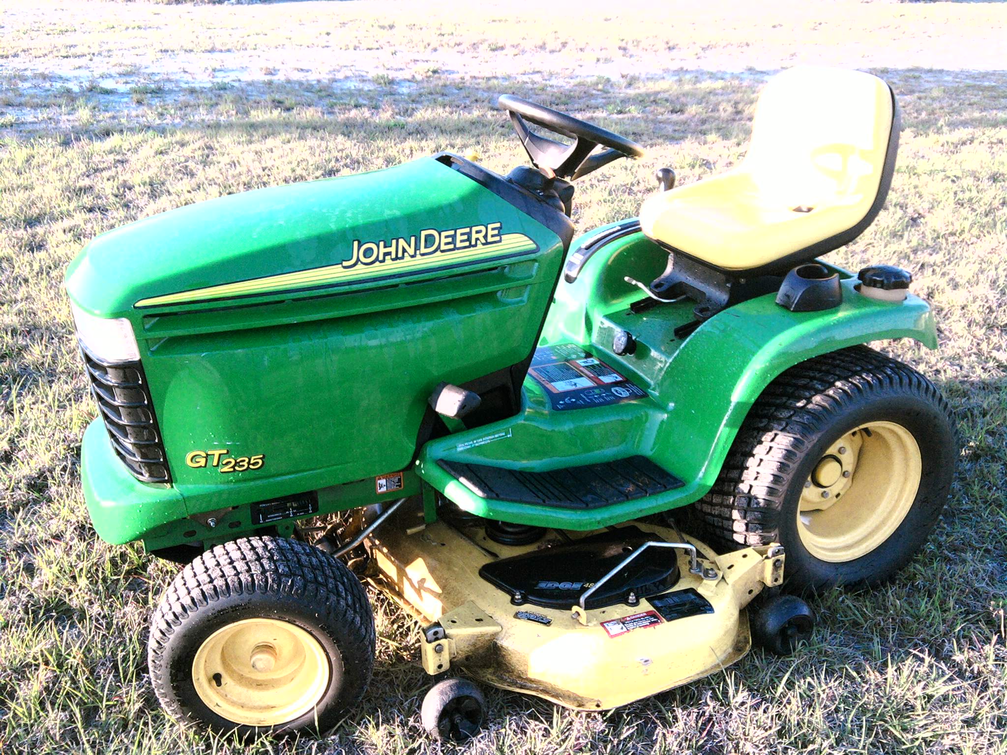

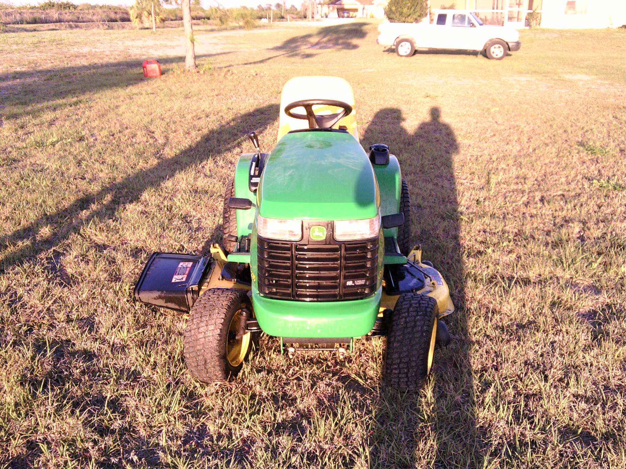

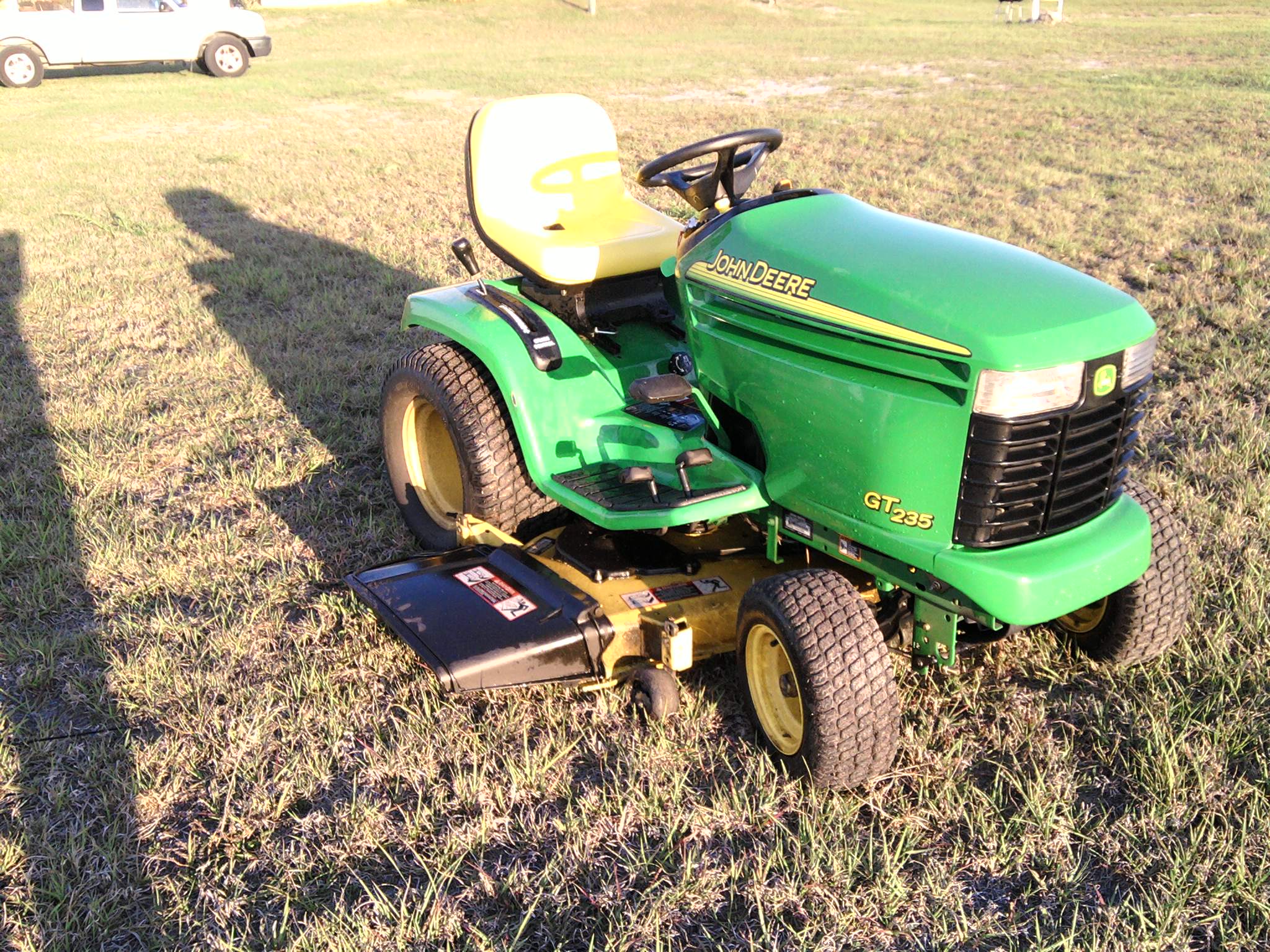

Dont know much about grass collector for JD gt235(garden tractor).Even though I believe getting one that fits at a JD dealer should not be a problem.I can tell you I bought mine new.I now have way over 300 hrs,and could not be happier with mine.There are days I think it will out live me(Iam 52).:laughing:.I wrote a review on mine,check it out if you havent all ready.Boone
