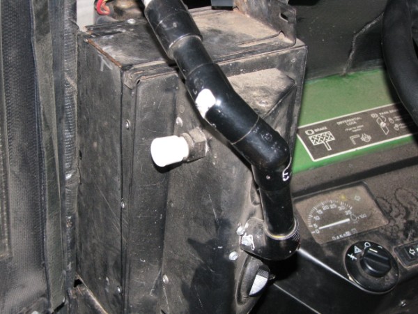

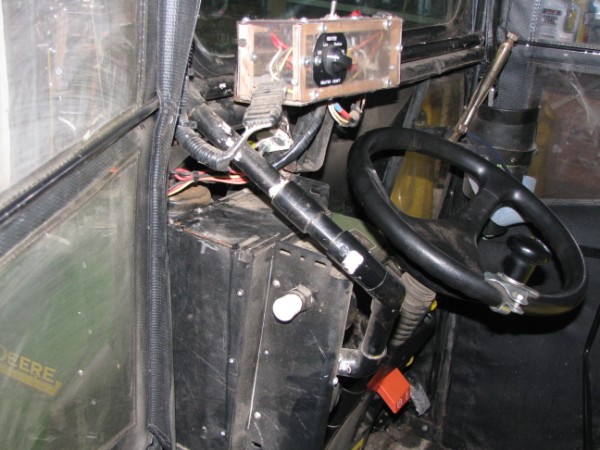

You'll be pleased with your cab much better than setting out in the wind ,snow or rain.. Here is the way I mounted my heater ... and then used 3/4" hot -cold water line to put air on windshield.Drilled about 18 holes apx 1/4" or larger to give air on windshield.. Last winter I ran another 3/4" line from bottom of heater starting with a T fitting pointed down on left side and then around dash to the right side to give some heat on floor.. Works fair , I can plow or blow snow with light weight boots now instead of my best insulated ones.
I'm also leave frame work on tractor yr around.. remove back ,doors, and front lower curtain... Last few yrs I have been leaving the windshield in place.
At Advance Auto they started selling led lights that look something close to these..
http://www.ebay.co.uk/itm/High-Watt...r_Truck_Parts_Accessories&hash=item1c1fa9fd71
They flash 3 different patterns .. I've seen them on road construction sites. Didn't know this when I bought them ($40.00) also lights can be burning solid not flashing.. There 's 20 led lights on each light.. I mounted them on back of tractor and just having them on I can back in my bldg and see very well ..
Just my take on this !!
