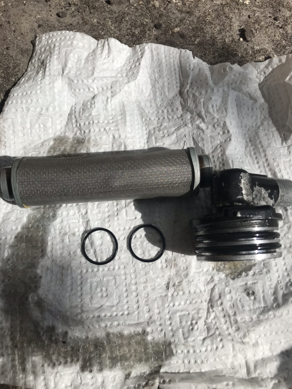

I have a 2010. Jd2305. I replaced the hydraulic fluid, filter and pulled the screen out, cleaned the magnets & screen. Reinstalled. Once I pulled the tractor out of the garage, right where I pulled the screen out lay two O-rings. They aren’t the two that go on the cap that holds the screen in with the hose connector on it.

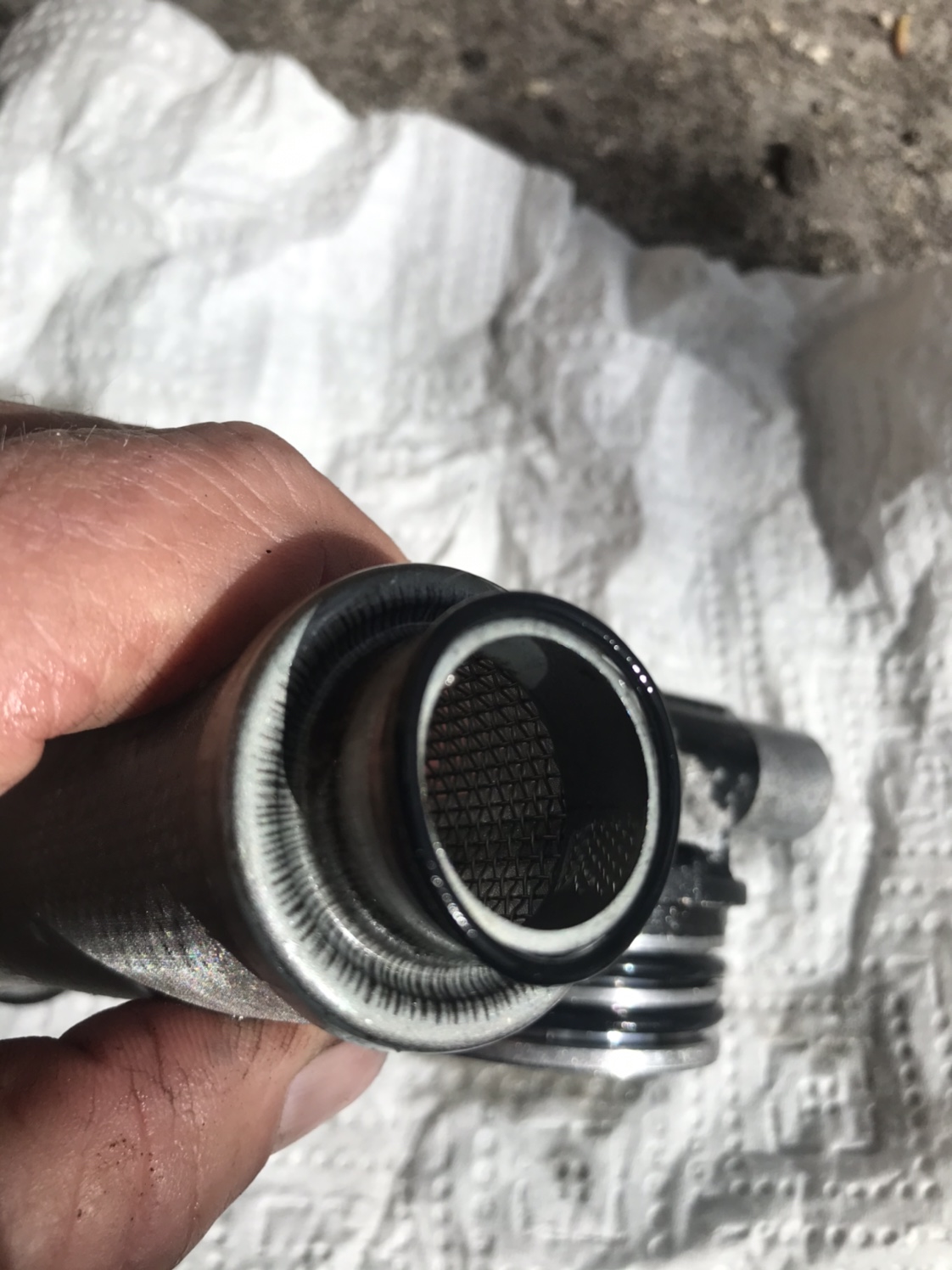

I ended up draining, pulling the screen back out. The o-rings fit perfectly on the nipples on each end of the screen.
Does anyone know if that’s where they go ? I’ve googled a pic of the parts breakdown and it doesn’t show them.
Thanks to anyone who has an idea ! 100% sure they came from in there somewhere- not sure. Ugh

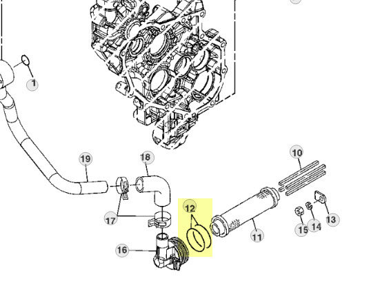

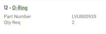

Check the illustration below from JD Parts. I believe item #12 is the two O-rings you are looking for.
Thanks for the reply, but No, They aren’t the two O-rings that go on the cap. Those are approx 2” in diameter. 1/4 “ thick.
The two I found on the ground are approx 1” diameter. 1/32” thick. (Very thin)
I should also add, I have 550 Hours on the 2305. All by me. This makes the 6th time I’ve cleaned this screen. 50 hour. Then ever 100. So, Looks like I would have seen theses before.
I’ll try my best to get a pic on here within the day.

Good guess, thanks... the drain plug has an aluminum washer, fill plug has an O-ring. But half the size as the two I found. I just attached pics for a better understanding of the size.
