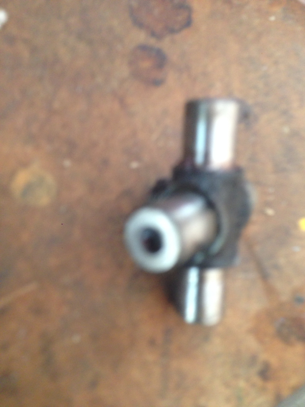

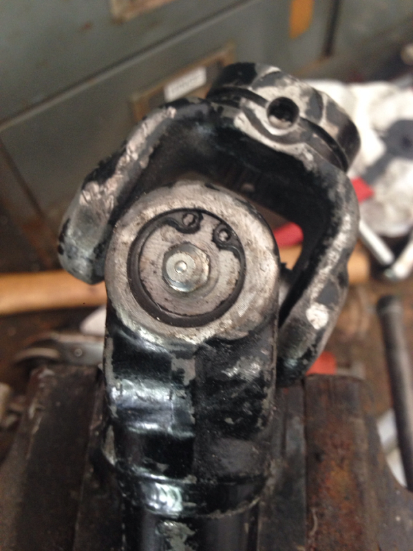

I have a 2010 -- jd2305 with 250 hours. Grease for the u joints on the driveshaft is hard when installed. After buying all kind of adapters, I started pulling the drive shaft down myself every 50 hrs and greasing the two u- joints (spider) while off the tractor. With that said, found one this morning that's going bad. I called the dealer here in Orlando- $49 each. I seen here on TBN that some have changed to the ones with the zerk on the cap. Using PUJ 410. Or Napa C410. Part numbers. Has anyone done this on a 2305 ? Can't seem to find a thread posted about it.

For any that read this thread... I ordered a regular 410 u joint- ( no "c". Or "puj" Just put in on. The star shaft was a 1/6th to long. Hit it on my polish grinder, cleaned up the holes with a dremel sanding drum and it all fit perfectly. With the zerk in the end of the cap, no more dropping the shaft to grease. Cost $44.00 for both

I put them on, had to grind 1/6th off the post for snap ring to fit. Cleaned up hole with dremel drum sander. No more droping shaft to grease. Worth the $44 dollars do both

Yes, bought the 2305 new, didn't learn about the hard to reach zerks till probably 150 hours. Started dropping the shaft and greasing every 50 hours. When I dropped it last week, I could feel the slop and grinding on the forward u joint. No one replied. to my first post so I ordered the plain 410 u joint. I couldn't be happier. I'm able to grease both. I haven't tried to do it with the deck on, but sure I can. The zerks on the end of the cap are genius. On a side note : being cheap, I tried to drill one of the caps on the old one, so I could put my own zerk in. Couldn't get any carbide bit to cut it. Like I stated, the only modification was - had to grind a 1/6th off all for post to shorten it. If not, the snap rings won't go into the groove.
