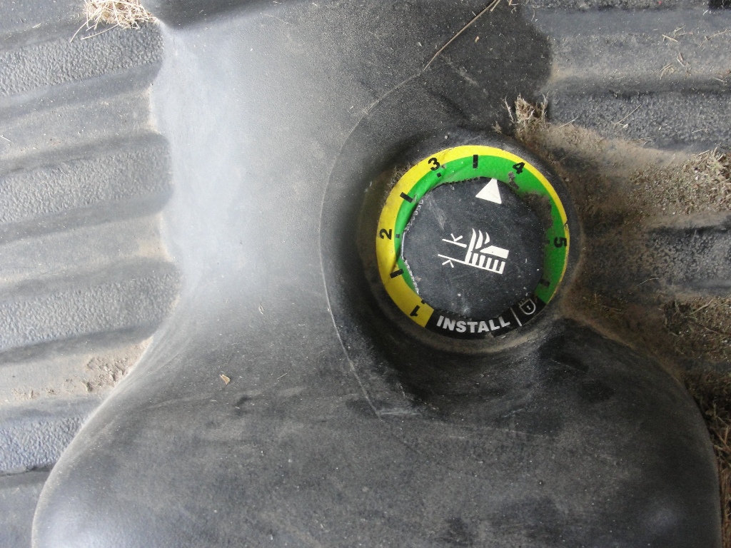

well not so much lift issues, but lowering to the varrious heights on the lift scale. For instance , it lifts all the way and lowers all the way but the settings inbetween, for 2 -3-4 inch does not seem to "catch" I can't figure out how the cog system works, mine spins freely 360 degrees, any advice or serivce adjustments

Just to clarify - do you have that knob in the middle of the floorboard with Lock/Hi/Med/Low on the dial? Do you have mechanical or hydraulic lift kit?

I have the hydraulic lift, and the knob has inch increments from 1 -5 - it is in the middle of the floor board

I'm thinking if your knob spins freely, all the way around, it's probably sheared the pin that holds the adjuster to the knob shaft, or maybe sheared the knob pin that holds it to the shaft. I'm guessing it's been very difficult to turn for quite a while and finally just spins??

The knob will spin "freely" (ok, with just a little friction) 360 degrees when it is in correct operating order *and* when the mowing deck is fully lifted. You don't have to remove the floorboards to service it.
Is your knob perpendicular to the deck, or is it at a slight angle? Many people have had the mounting bracket for the knob come loose and this can cause the problems you describe. If should come straight out of the floorboards and not ahve any side-to-side wobble.

it will spin freely without stop , I think it is straight but will double check. sounds like I need to remove mower , get her up on ramps and take a good look, thanks for the information!
That indicates a problem. If you look at my picture below you see a picture of a padlock in the 5 oclock position. That position is how you lock the deck at the highest position. That position is also a stop, turn around the other direction to the install position, which sets the deck at the lowest position and you hit that same stop. If you can turn your knob without stop something is wrong. Also with the deck lifted when I turn my knob I feel detents, probably twenty in a complete revolution.

IMHO, it's not a stop. If the deck is adjusted properly, you can spin it 360 *without* hitting a stop. If you hit a stop at the lock position, your deck can go higher.
You can confirm this by crawling underneath with the deck off and having someone spin the knob while you move the lift arms.
Look at the pattern of adjustments on the cam from underneath and this should make more sense.

This is correct.. It should spin 360 degrees
On my 62D I finally got knob adjusted correctly BUT there arent many positions that are actually useful..
The knob controls a cam that has 'steps' on it.. At the widest part of the cam is the LOCK position. The first position down from Lock gives me about a mowing height of 4" - the second step down from Lock gives me 3".. 4" is where i normally mow but the 3" gives a much cleaner look.. I am trying to figure out how to get a 3.5" position.

thanks gang, looked closer today and it seems the cog on mine is worn some and the shaft has some play, hard to access without removing a buncha stuff, so still looking and scratching my head...
