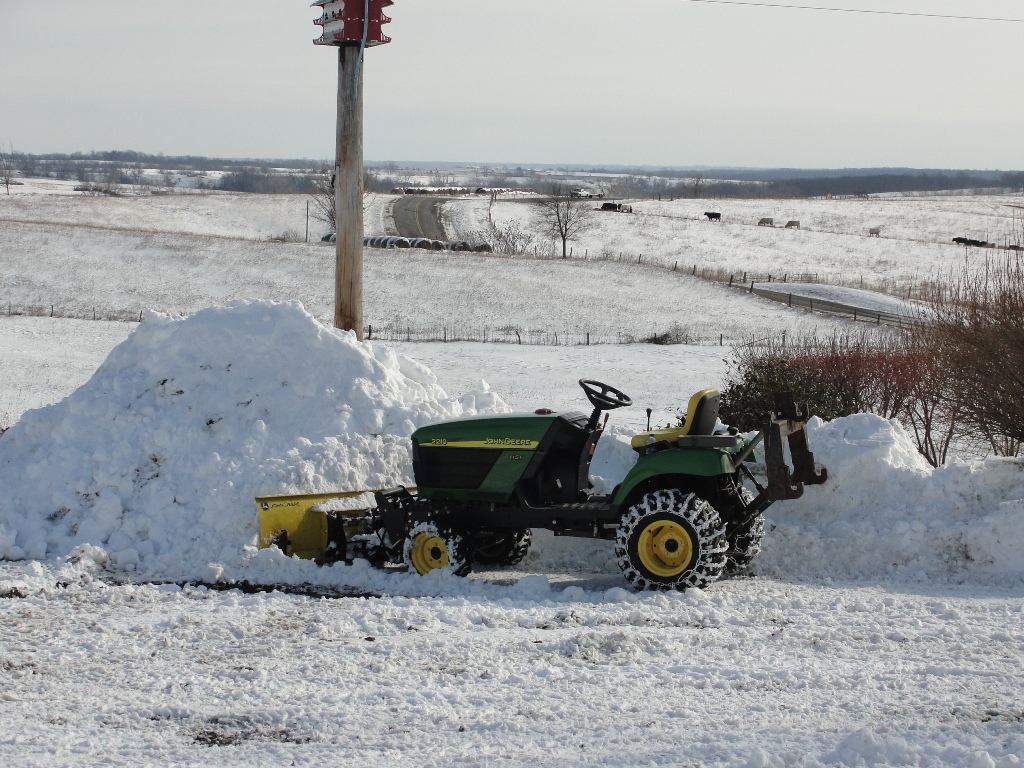

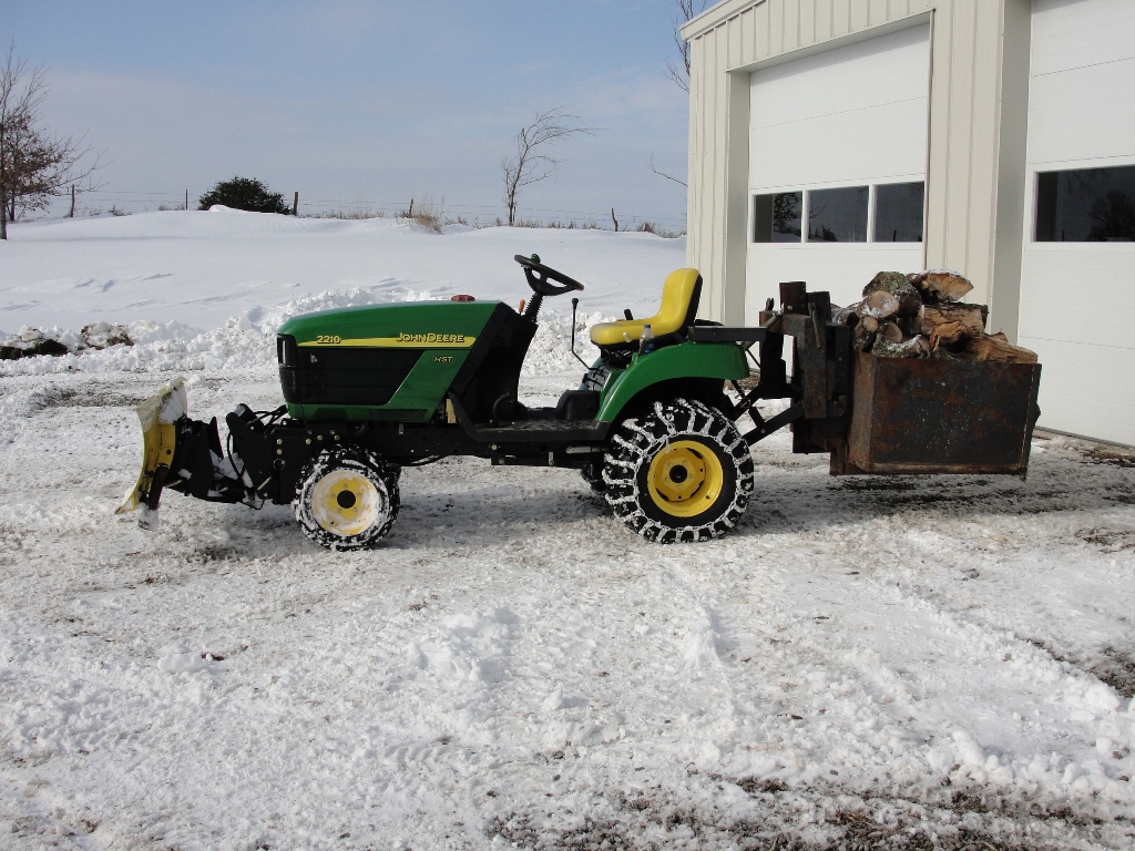

I have the snow blade for my JD2210. I've used it a couple times since buying. As ChrsDrn described, it's fairly easy to put on.
It's very easy to use and as mentioned is great to clean against the garage doors or a sidewalk. I've got a blade for my ATV but it's mechanical angled. I never use it, too lazy to get off and change angle. ;)
I first used my JD2210 without chains. I have a section of driveway that's elevated above the yard. Got too close to the edge and found myself down in the yard trying to get back up on the driveway. Went back to the shop and installed the rear chains (too lazy in the beginning) and get along fine.
Prior to this machine I had a JD455 with the same blade. It mounted closer to the machine on the 455 and I liked it a lot better.
The 2210 carries it quite a ways in front of the front tires which makes it less manuverable in tight spots and also makes it a little harder to control height if trying to carry it. I built some adjustable circular pads for mine and it works a lot better than the factory little flat bar pads.
I don't get enough snow to justify a blower. But it was hard to justify the $1200 I spent for the blade too. :eek:
   / JD 2210 snow plow? #7
Forgot I had these pictures. They show how far forward the blade is. If you can look closely you can also figure out how it installs.
