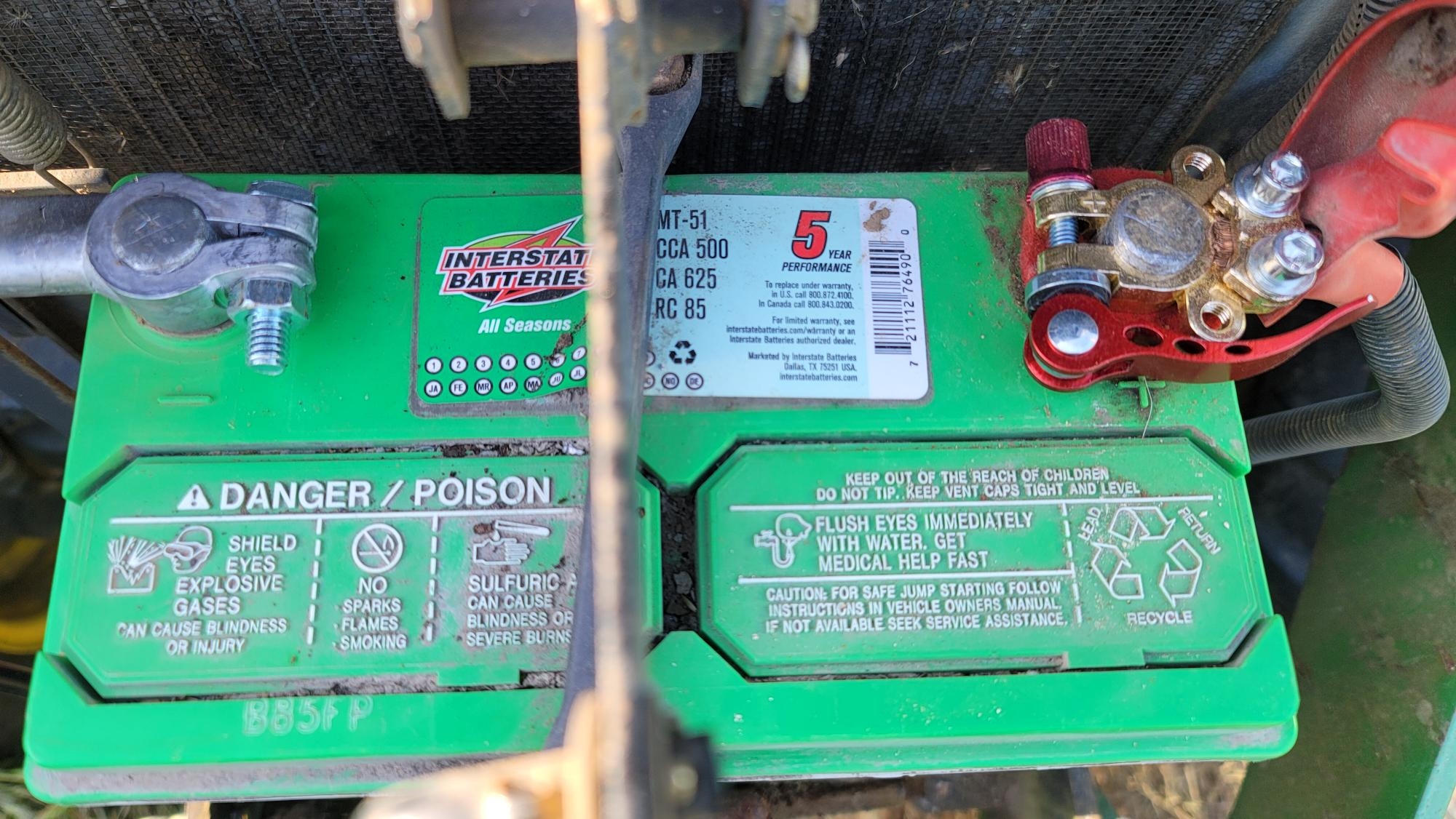

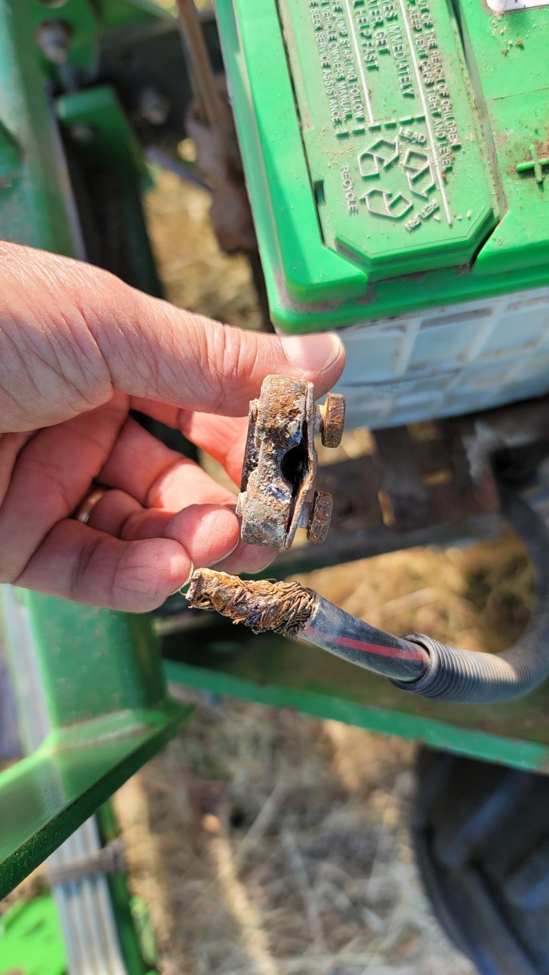

Thanks to those who provided suggestions on things to try to resolve my problem. The tractor is RUNNING! I replaced the positive battery cable connector with an overnight shipment from Amazon that cost $9. The JD cable was 15x's the cost and would not arrive from Illinois for a week. It took 5 minutes to cut off the corroded cable-end and install the new connector.
The turning point was when I measured the resistance of the positive cable from the battery terminal to the starter lug. It measured 83 Ohms! For a minimum 50 amp draw, the resistance would need to be less than 1 Ohm. Bingo! My earlier mistake was measuring the voltage, forgetting that the multimeter requires minimal current.
I posted before and after pictures for future reference. Nothing "runs" like a Deere!
