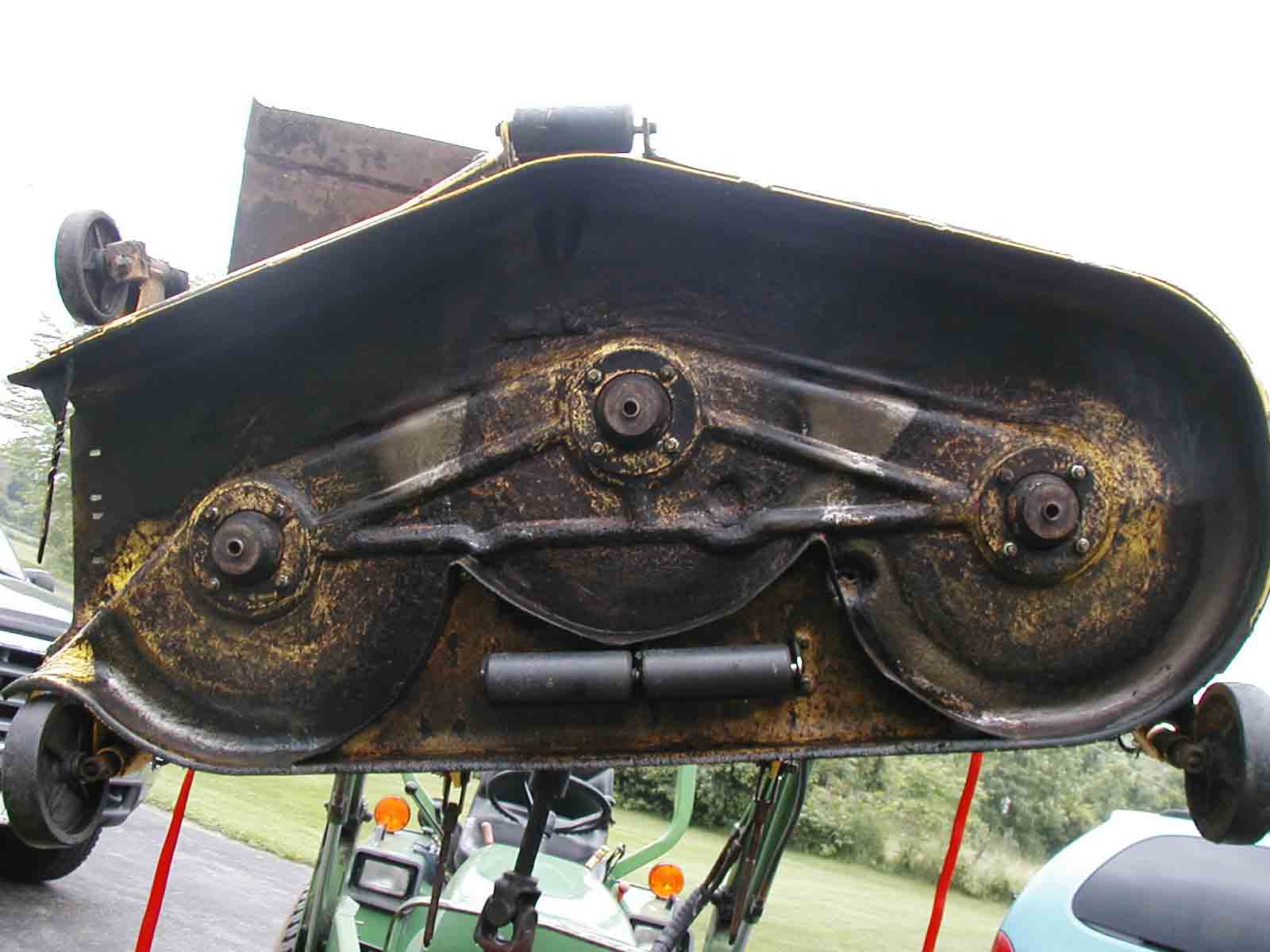

   / JD 2210 FEL #6
<font color="blue"> As for cleaning the deck... is their a right way to attach chains to keep the deck balanced while hoisting? </font>
I lift my deck with 2 straps placed just inside the loader arms. With 2 straps you don't need to worry about balancing.
I lower the bucket, slightly curled down below level, until it just touches the deck. I attach one end of the strap to the front of the deck, run the strap over the bucket and attach the other end to the rear of the deck. I tighten down on the rachet to take the slack out of the strap. I then raise the deck and curl the bucket all the way back. This leaves the deck in a near vertical position making it very easy to change blades and scrape ( I place a trash can under the deck and let the grass clumps fall into it).
I am not sure if this will work with your deck/loader combination. If you try it, do it slow and make sure nothing gets pinched or damaged. You may want to place an piece of carpet or cardboard between the bucket and deck. I find this works better than just hanging the deck from the bucket as the bucket behind the deck keeps the deck from being pushed away as you scrape.
Picture attached.
Jeff
