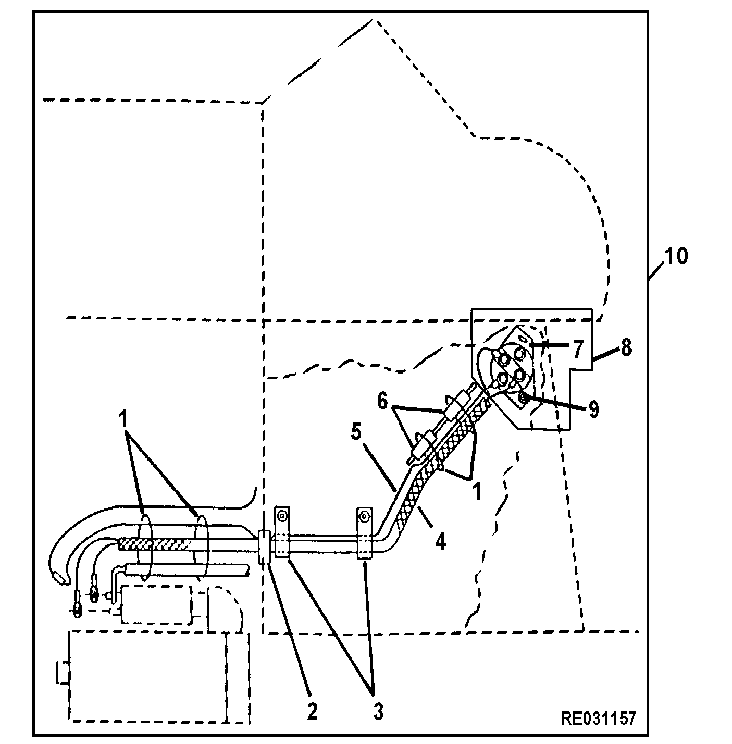

This is the solenoid aka relay( RE170320) that I was referring to about checking voltage/ground.

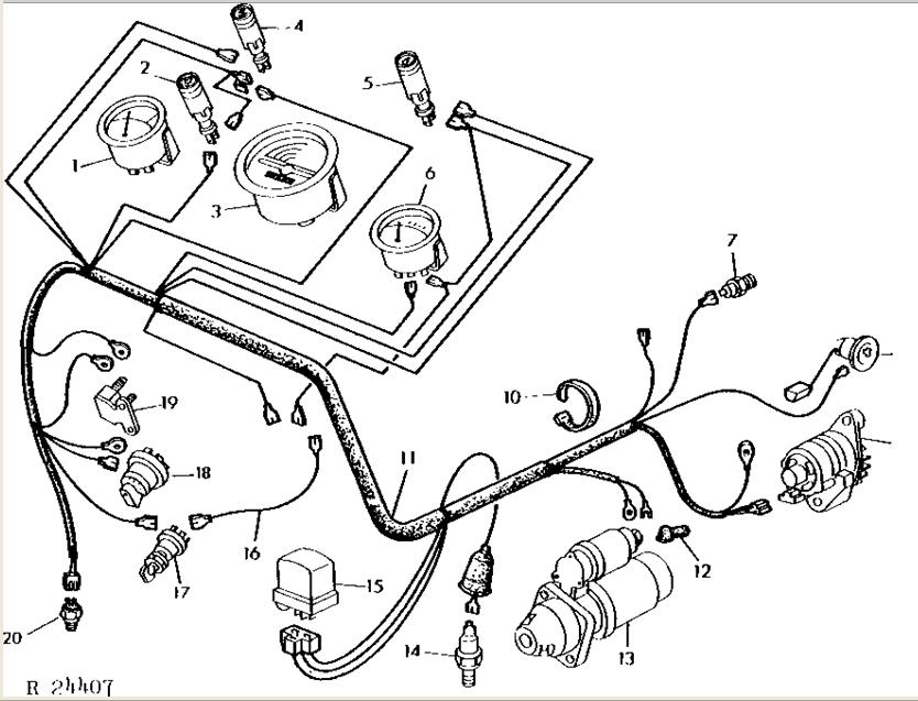

Don't know if this will help, but here is jdparts pic of the wiring harness.
A schematic should be obtainable at your Deere dealer.
#2 is alternator lamp,
#4 is air cleaner restriction,
#5 is engine oil pressure
#7 is air cleaner restriction sensor
#14 is engine oil pressure switch
#17 is starter switch
#18 is light switch
#19 is circuit breaker
#20 is neutral start switch
