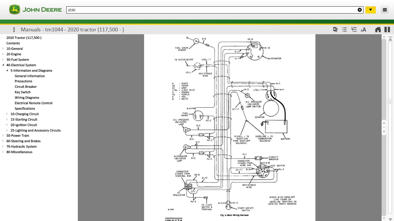

Hey guys. When I got this tractor I noticed there was a battery disconnect switch on top of the batteries. If I don't disconnect after turning it off, the dash lights stay on and the battery will run down..
Does anyone know where I can find where the wires off the ignition switch are supposed to go?
Apparently at one point someone had tried to get the lights working again, or so I was told. Oh yeah the lights don't work at all..
Any help would be appreciated.. I'm going to try to trace down wires and possibly light switch wires to see what's up.

That looks like it's from a service manual not parts
   / JD 2030 ignition wiring
Oh OK.. Nevermind. :)
I need to find a service manual.
