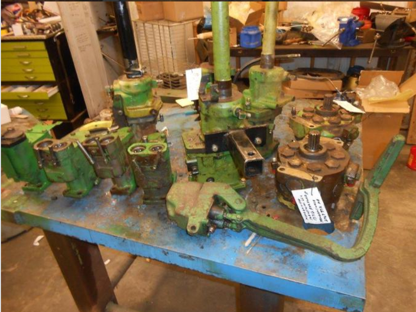

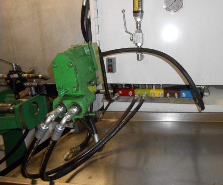

More than likely 1 or more of the 4 poppet valves is not seating correctly. To R&R & properly adjust these poppet valves requires some finesse & prior experience helps. Valve clearances must be adjusted with a dial indicator in several thousandths of an inch. I know of a technician in Ohio that renews a lot of these type JD hyd control valves. He built a test stand so he can be sure the valve will operate correctly & not leak. He accepts shipped in valves for repair. I have his contact info if you need it.
IMHO JD hyd control valves are way too complicated just to control a hyd cylinder or steer frt wheels.
Another possibility would be to install an ind 2 spool valve to control FEL instead utilizing SCV.
Way back when I was a JD dealer service manager I had several grease monkey's so called mechanics under my supervision that could not repair JD hyd control valves the 1st or 2nd or sometimes more attempts.
