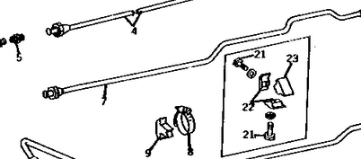

Are line spacers(parts keys 9,22 & 23) in place with clamps? I've seen spacers removed when splitting tractor to repair clutch but not replaced(lazy technician). How long since hyd filter was changed & sump screen(parts key 15) checked?
