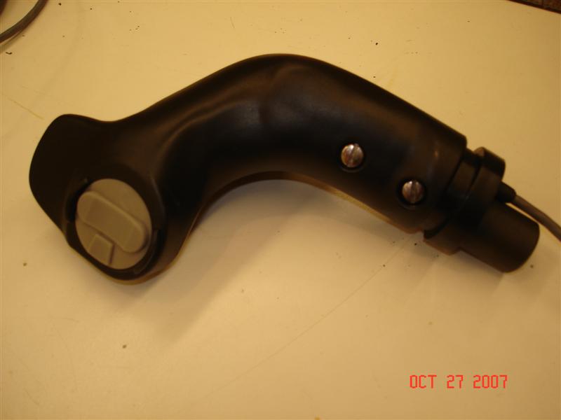

Yes, I am interested in the tractor. The hoe attachment was not on it when I looked at it. The top-n-tilt 3pt was on. On the joystick there were five buttons. What does the fifth one do that is most forward?
   / JD 110 TLB Aux Hydraulic Noise #5
jgbanshee,
Mine has three buttons, the button in the most forward position is a momentary switch which swaps the diverter setting from forward control to rearward control of the three valves. The rear two buttons which are vertically stacked control the third valve and this is duplicated by the AB switch mounted on the lower console (outboard).
The inboard mounted switch closest to the seat I/O turns on the auxillary hydraulic circuits which allow you to operate the diverter. When this switch is on a diagram on the dash should light up too showing whether you are in either front control or rear control of the three hydraulic circuits. Pressing the most forward button on the joystick should cause the indicator on the dash to switch from front to rear control display. This will swap back and forth everytime you push the button.
I haven't seen any of these with five buttons on the fel control lever, only three. Maybe the last two buttons you are referring to control an ejection seat or tail rotor.:confused2::laughing:

Oh, and I have to look again at the 5 buttons on the joystick. I assume I was mistaken.
Here is a picture of the factory handle for the 110's, I bought one and installed it on my tractor.
