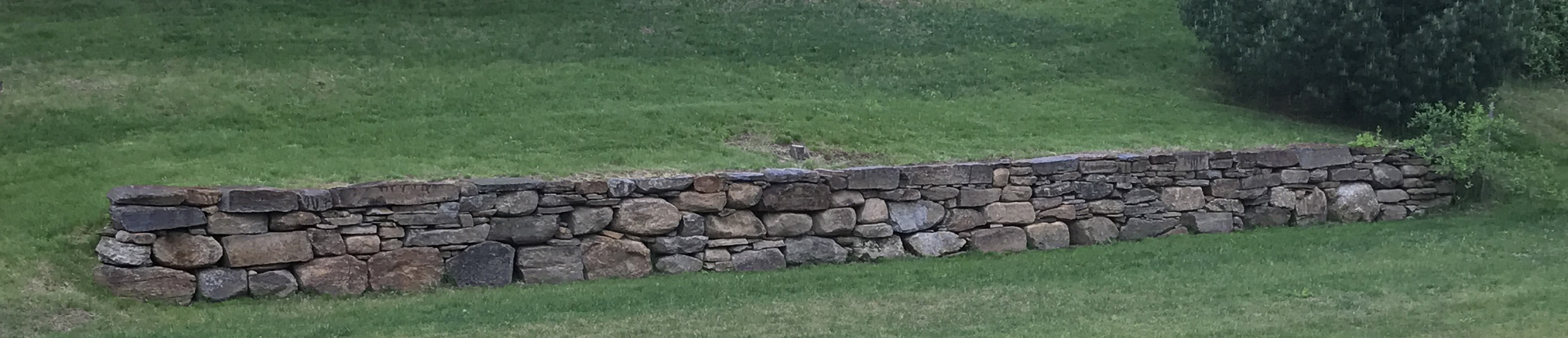

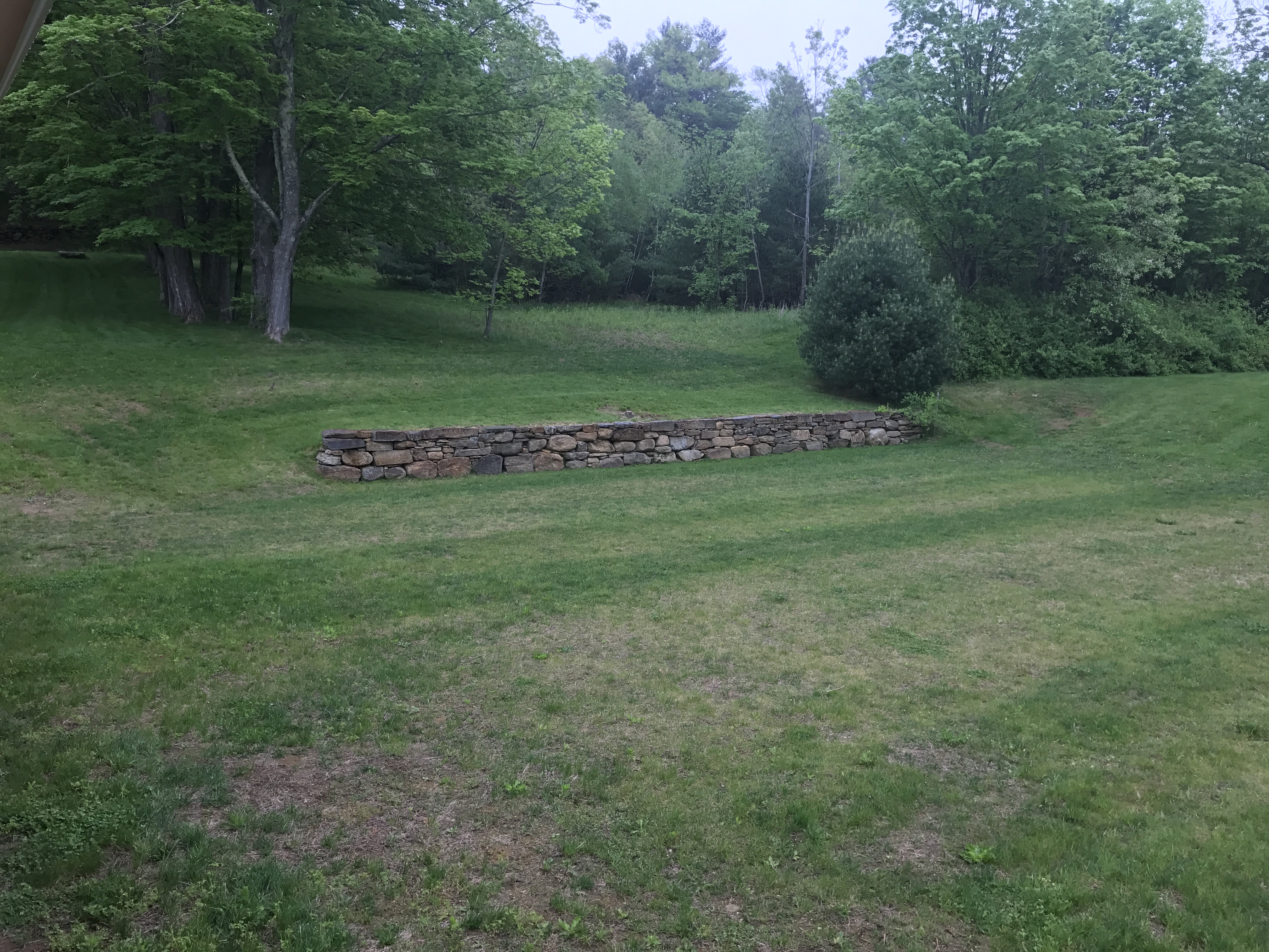

Yes, I hear you. My first machine was a JCB 214S. I got the biggest stuff done with that and then went to a JD 3033R. I finished up with that and sold it but now just annexed the property next door which needs work. When I went from the JCB to the 3033, the JD seemed very tippy and barely capable of handling decent sized rocks. I know these SCUT machines have serious limits but I still feel that the ability to carefully handle the occasional larger rock with the JD is kind of a big deal. If it weren't for the better FEL lift capacity and the slightly longer/wider wheelbase of the JD, I'd be all over the new BX23s...sweet little machine. I also considered a Kubota B2601 TLB. The FEL on this machine is spec'd out to perform about the same as the loader on the JD 1025r. But it's a longer/slightly wider machine (only slightly heavier than 1025) with larger wheels. I suspect this would give more stability when I do try to tackle a larger stone. It's also about $5k more expensive than the JD1025. What do you think...even though the FEL on the B2601 rates about the same as the JD 1025r, it probably would more safely/stably handle those larger rocks? The JD 2 series is getting too large for me...I'm concerned about compressing grass roots. Here's a retaining wall I did with the JD3033r...the larger rocks wouldn't go with the 1025r I'm sure but I'm guessing I could muscle many of these with the 1025, but possibly not with the BX23s retaining-wall-closer.jpg

   / JD 1025r vs. new Kubota BX23s - time to resurrect the debate #7
We had a local fellow that built walls like that totally by hand.He was in his 70's when his "helper" took over the business.
