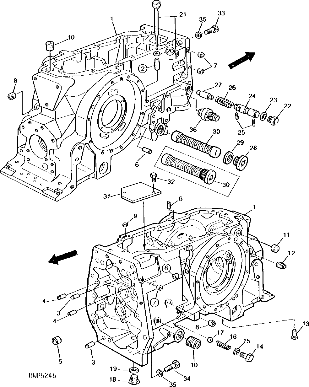

When you say sump do you mean the transmission?? or the resevior up front by the pump. my manual says it holds roughly 10 gallons of hydro fluid do I drain it and the use enough of this mixture to fill it?? .
Screen is part key 30. Although when totally dry trans holds 10 gallons you will probably only get about 8 gallons to drain out.
