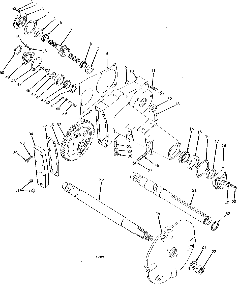

I was just given a JD 1010 tractor and I do not know where to check the different fluids besides oil and water. Also what kinds of fluids are needed? Thanks for the help.:)

JD Hy-Gard for hyd fluid. Check it at a plug by right heel when sitting in seat and final drives on each side.

Thanks TX Jim. Now where do I fill in from? There is a breather cap under the seat is that the place? Also any other fluids that I need to know about? Also you mentioned final drives does that take the same fluid and if so where does it fill from. Sorry about asking all these questions, I am new to the JD 1010. Again, thanks.
   / JD 1010 RS Fluids #4
One fills the trans at the check plug by right heel. Fill it to full(level in hole). On the final drives,there are fill/drain plugs(parts key # 31) on each flat plate on each side.
