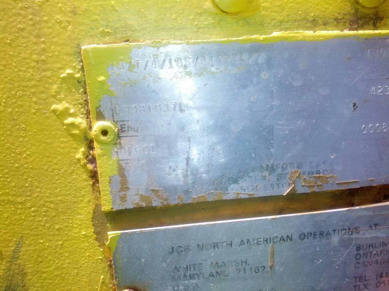

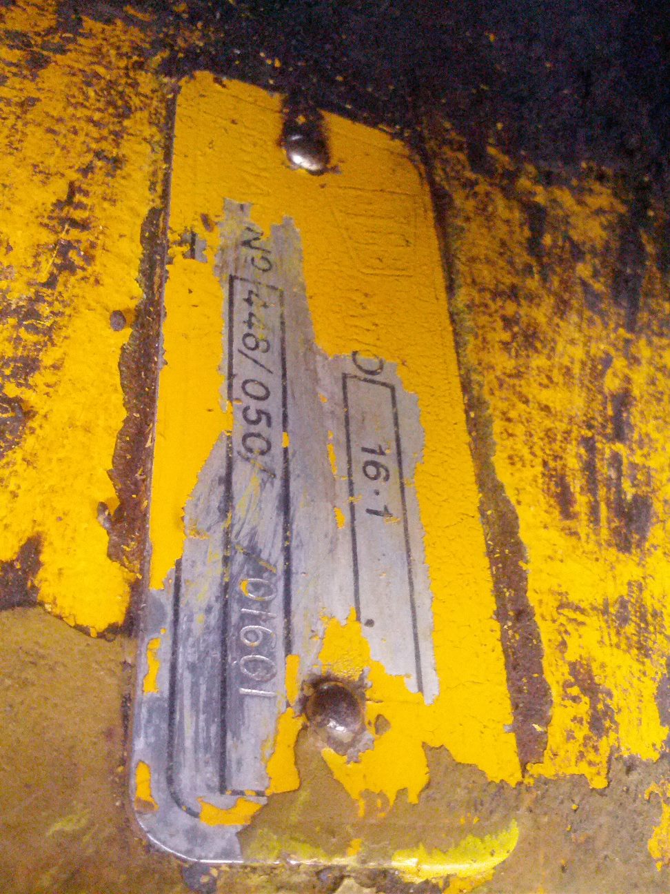

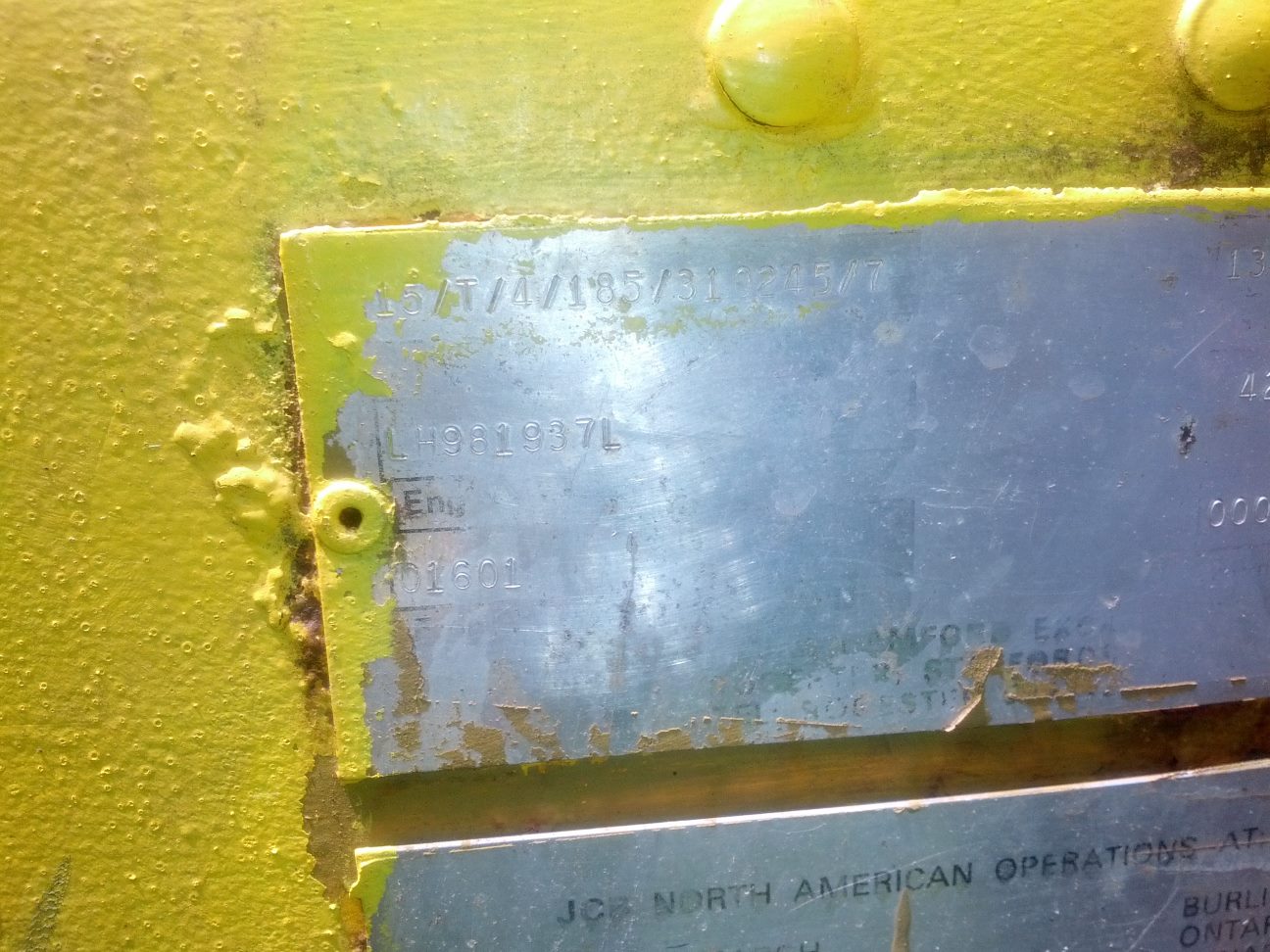

I've recently acquired a 1984 JCB backhoe. It says "3C" on the fender, but I believe it to be a 1400b model. It has the 4236T Perkins turbocharged engine in it and runs like a top.

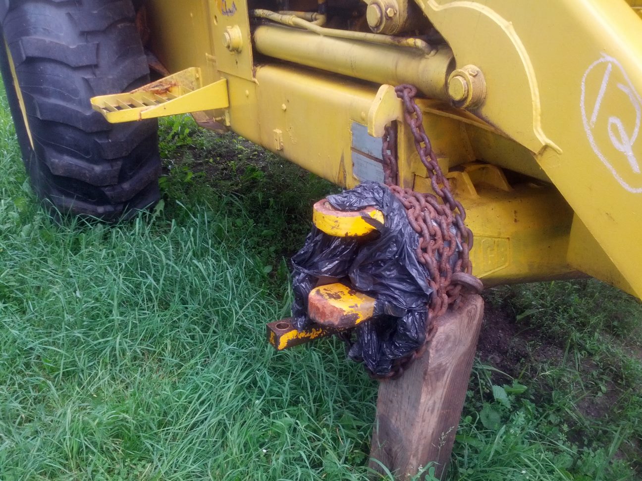

Unfortunately it's missing a front corner. Everything from the axle to the final drive to the housing... the last owner took it apart and "lost" all of the pieces. I've got a suspicion they were mistaken for scrap. Anyhow, I've been having one heck of a time finding a source for used parts online. I know there are probably hundreds of compatible machines sitting in the weeds all throughout the country just waiting for someone like me to come along and buy the parts.
Can anyone supply me with leads? The axle appears to be a Dana (it looks similar to our Ford) but I haven't been able to figure out exactly what it is. On the build plate there is a number "01601" (or 0169 - can't read my own writing) that I think has something to do with the axle.

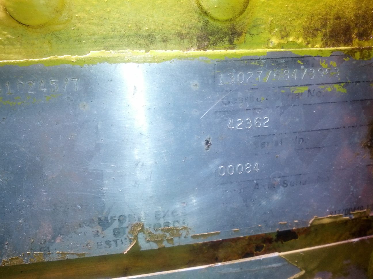

Photos attached...
Build plate on the side of the machine

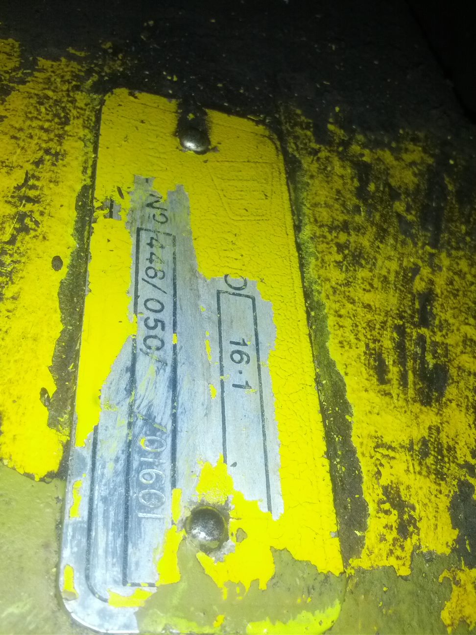

Axle plate (left side of the front axle)
Showing what I'm missing. I do have the tire and rim.

Serial Number:  Ex Works date:  Engine Number:
310245            29-Nov-1984      LH50133U/981937L

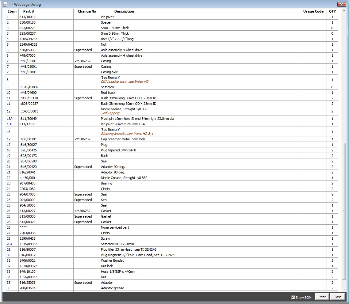

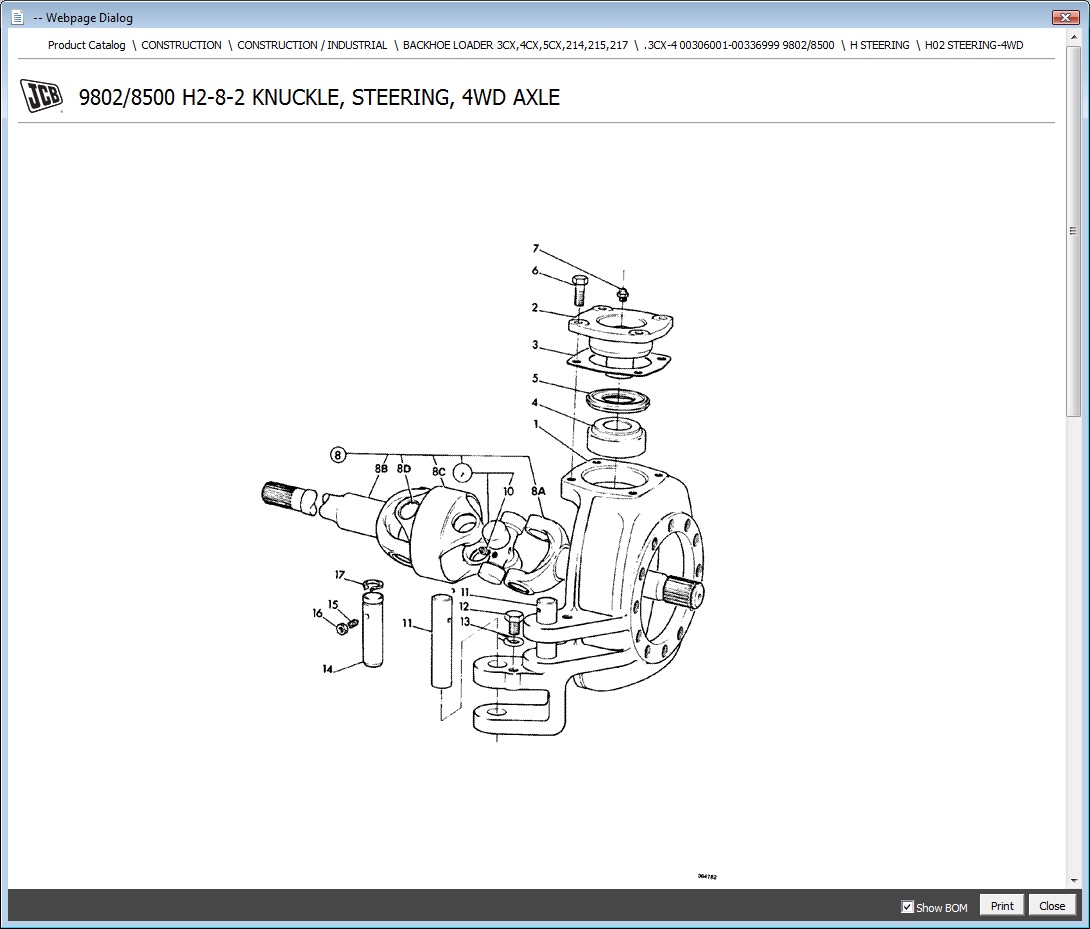

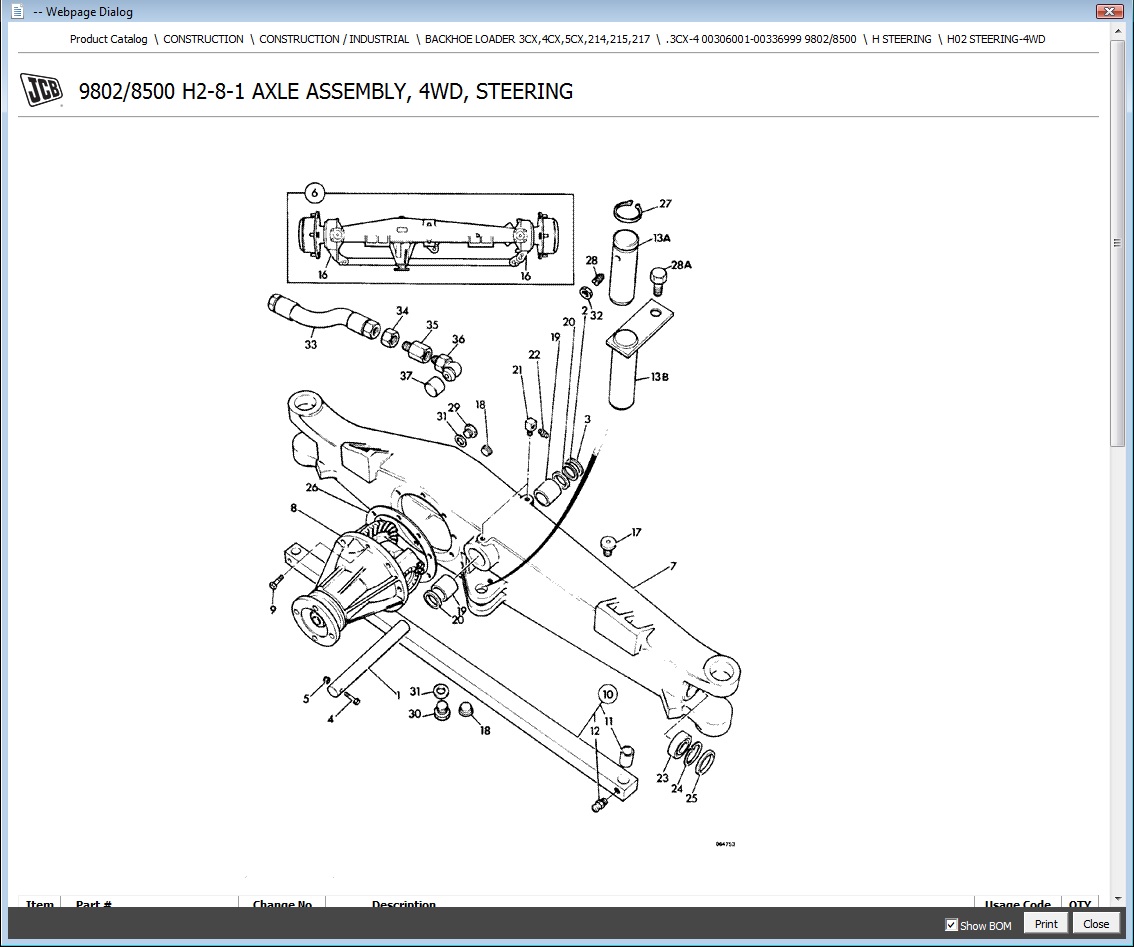

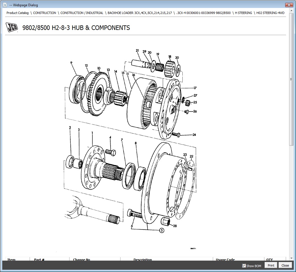

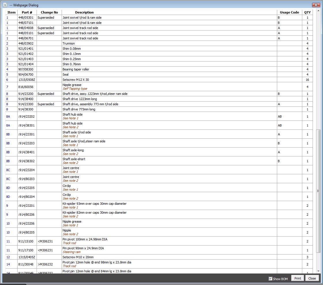

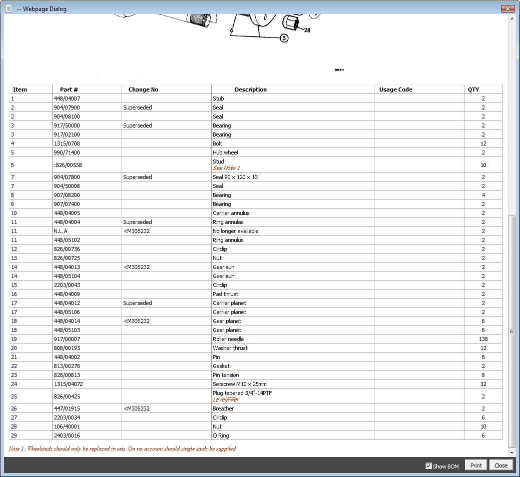

Here is what I THINK are your parts diagrams, I'd go to a dealer and make sure I looked up the right parts. For newer machines the program allows me to type in the serial number and it gives me the list of parts. For yours I had to manually look up which parts list to use based on serial number.
If you are in Ontario try Home they may be able to tell you where to look for used parts.
Oh and I believe the 1400B is the same as the 3CX, it was called the 1400B in North America, 3CX everywhere else. I think...
3cxFrontAxle.jpg3cxFrontAxlePartsList.jpg3cxFrontHub.jpg3cxFrontHubPartsList.jpg3cxFrontKnuckle.jpg3cxFrontKnucklePartslist.jpg
