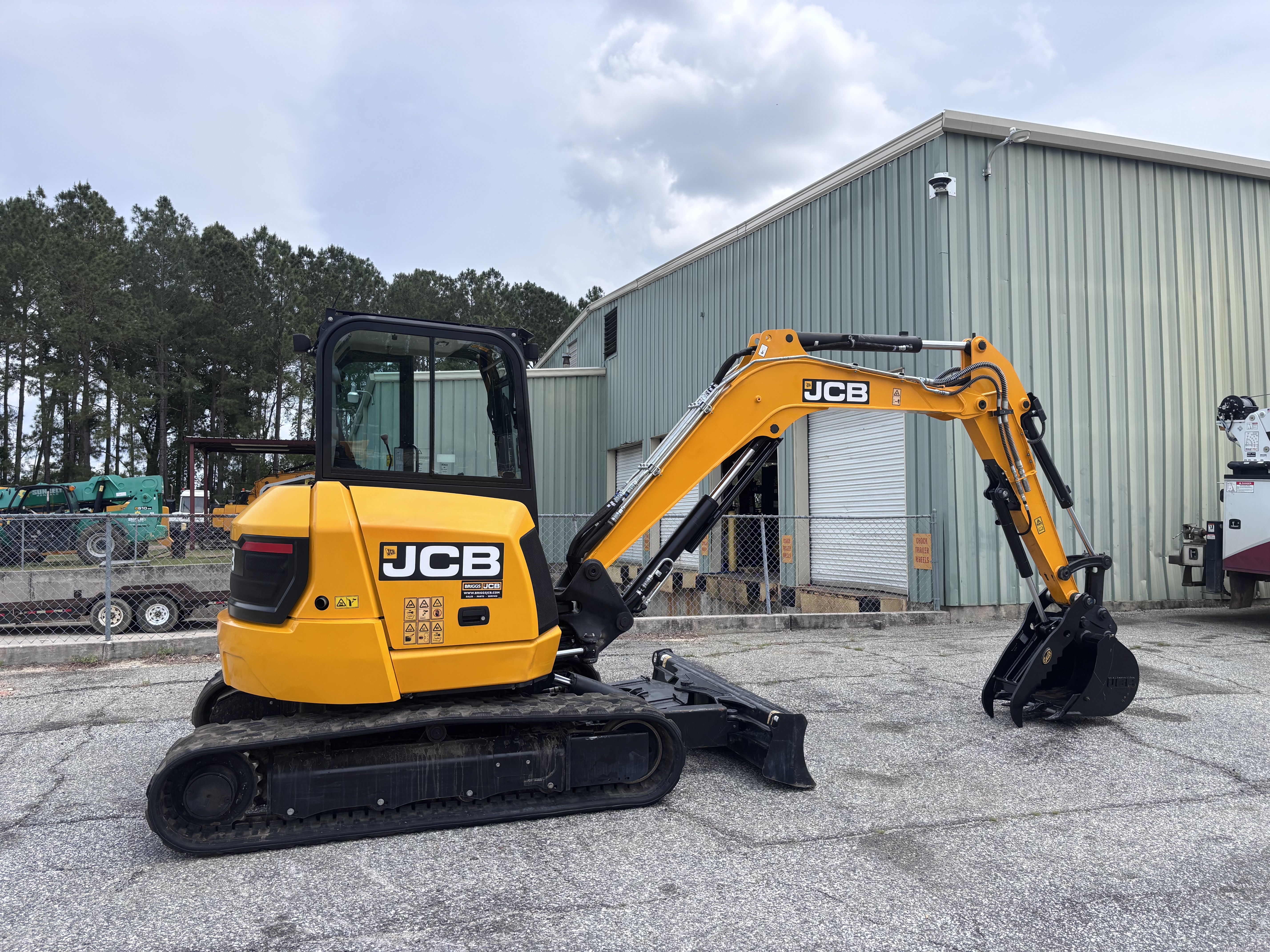

I have a JCB 55Z-1 that I bought a month or two ago as a dealer demo. It’s a 2022 model that had 84 hours when i got it and came with full 2 year / 2000 hr warranty. It’s the cab model with heat/AC. Offers almost 24 gpm on the auxiliary high flow line (has separate low flow plumbing for thumb) So far I love it. it replaced my 2021 Kubota KX71-3 that had 675 hours on it as I wanted something bigger.
