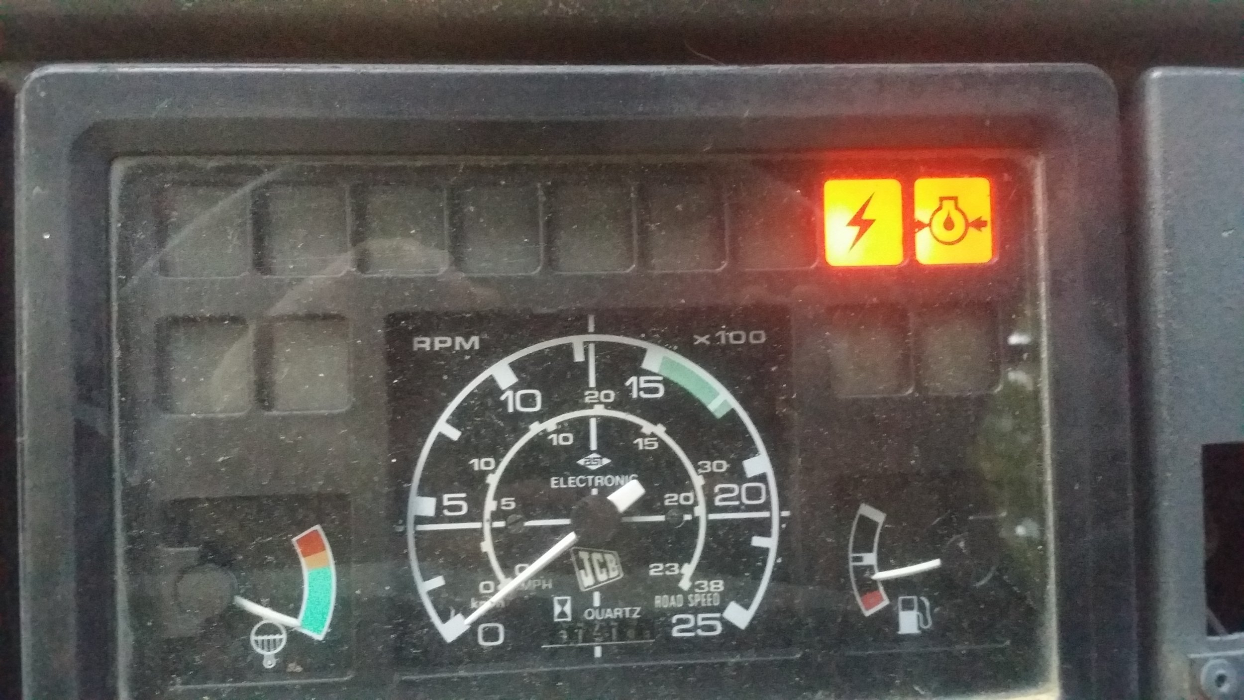

I have a 1400B JCB backhoe -- have a dash light that just came on (the one in the top right hand side, not the electrical symbol but the other) - anyone have any ideas what that light indication is? As in, I know the one to the left means electrical voltage low, but not sure of the one to the right. It comes on with the key on, starts up, goes out for a second, and then returns (so it seems like it needs attention).
I recently changed my engine oil and added some trans oil - I think they are both a little over full right now, but other than that, nothing out of the ordinary.

Looks like oil pressure warning light. Should go out within a couple seconds of starting. If not there’s a problem.

Yes; engine and altnerator as mjw357 said.
To troubleshoot, I started with a manual guage. All good. Cleaned sending unit, had some gook, reinstalled, have not had an issue since.
