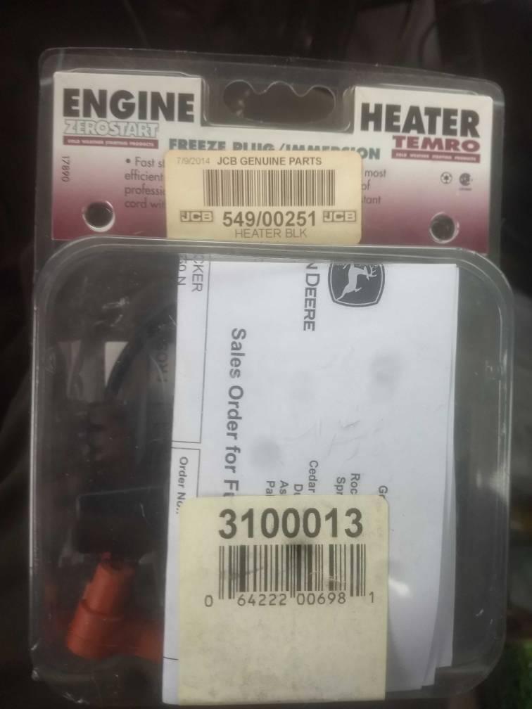

Does anyone know where and if these backhoes have a threaded plug for a heater to be installed? Was going to put one in the lower hose but wanted to check here first. My neighbor has this B/H and I help him out with it as needed. I work for a Deere construction dealer so I'm not too familiar with these tractors. It has the Perkins n/a diesel in it

Yes, it's been -10* or colder here the last few winter's. This tractor sits out in a old corn crib and I'm only trying to make it's life a bit easier in the colder months. Because if it needs work I'm the one who ends up working on it. Lol. I'll put an inline heater it the lower hose if that's all I can do but I'd like to not have to cut up the goofy lower hose. And there is not much room for the inline type to go on that hose

Well I found a JCB dealer that has them in stock
   / JCB 1400b block heater
   / JCB 1400b block heater #6
Look up Arctic Fox. They have block heater coils for almost any engine. They go in the frost plug.
But be careful when removing the plug. Don't drill in the cylinder.
I've got this on in my hands already. It was only 65$ But thanks for the heads up.
