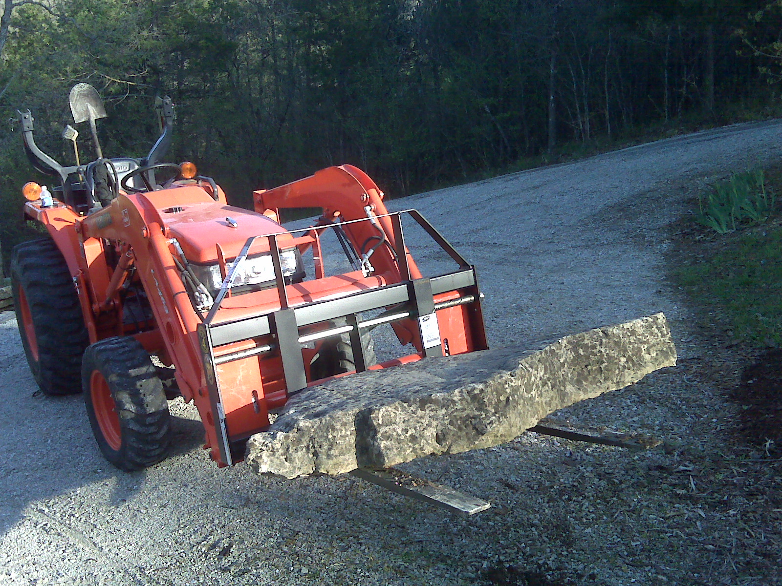

I brought home our brand new Construction Attachments compact tractor QA forks this evening, (yes Ted and Peanut, those videos work to make sales:laughing:)
They had been on about 5 minutes when Linda suggested it was time to get the "big Old rock" out of the flower bed. so we did. The forks are no worse for wear, the front tires were happy when it got off, and Linda was smiling.

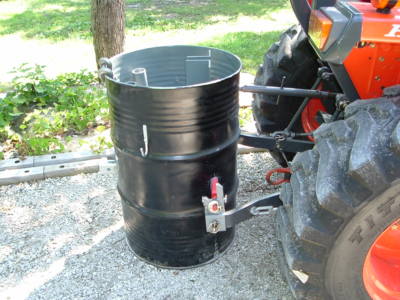

Looks great nice set of forks. I love the ones I have, don't know how I got along without them.
On a Side note, just curious what you have the shovels mounted in on the back of your tractor?
   / James & Linda abusing their brand new forks

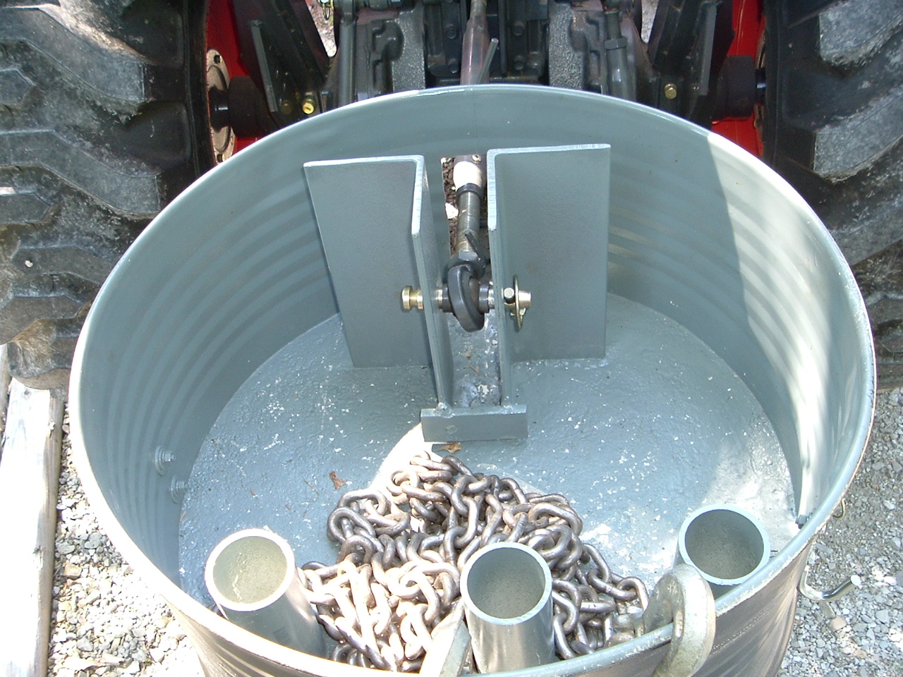

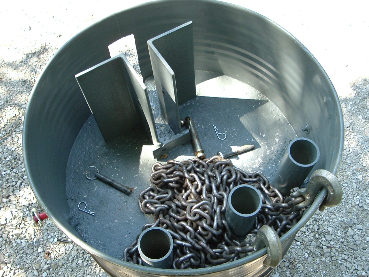

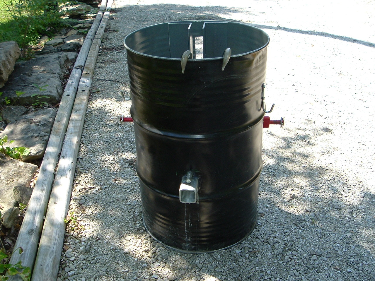

Here you go, about 750 Lbs of steel and concrete. 2 inch pvc tubes for the handle tools, best "implement" I have built so far. keeps my "rear end" on the ground, and carries all the misc. stuff you need to work.
