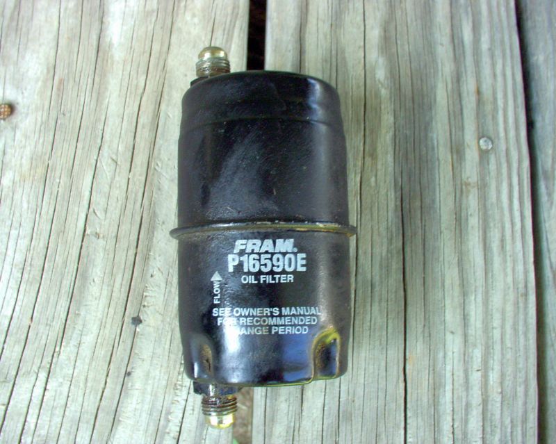

Anyone have one of these and know the hydro filter number? This is a 39 year old mower.

Does it have the eaton 11 trans? If it does mine uses a napa 1068.

I just found it right after I was on here. http://www.mytractorforum.com/showthread.php?t=201743
The Jabobsen GT 16 come with a Fram P16590E. Surplus center had a Zinga NPT7 GPm return line filter. I ordered that and two 6mx 3/8 NPTM connectors.
I don't think they make those old type filters anymore. The hydraulic lines screw onto each end. If I can figure out a way I will post a picture. Fram P16590E.jpg3+8++NPT+7+GPM+RETURN+LINE+FILTER_M.jpg

I found a filter like that when I was looking for one for the eaton trans. The price was over $100.00, it did not have the mfg name but it sure looked like the one you posted.

Gosh, that's pretty expensive. I put that on years ago but don't remember how much or where I got it. The motor hasn't been running in years until I put a new coil and regulator on it. The Zinga filter and connectors were only about 20 bucks at surplus center. I think that is an Eaton Hydro.
