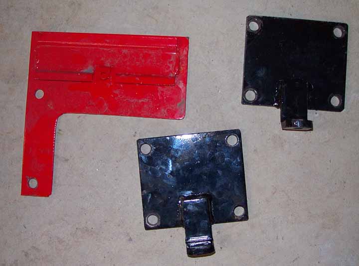

Hello,
My JM354 arrived to day (self import) and so far so good. I know everyone says the Chinese fluids are junk, but mine seems to be the exception. All look good so far. Battery even was full of electrolyte. All together in about 7 hours so it went much better than expected.... that is for a couple parts left over. Can anyone identify these? I have a few other parts too but I am pretty sure they are for the FEL.
Thanks
Bill

looks like maybe the plate that goes under where the ROPS bolts to the rear axle? and where the swing limit chains bolt on to

RonMar - Thanks! I plan on draining the fluids anyhow but I thought it was interesting how mine came. Since it is brand new off the boat, maybe they are changing the way they do things. The pallet the tractor came on had small wheels allowing easy movement and the assembly time seemed much less than others have mention. I assume due to less work to do. Everything fit fine except for the ROP that had to be "sprung" a little to get the pivot bolts in. Engine strarted right up and sounds fine. Going for a "test drive" this AM.
Schmalts - Thanks! I kind of thought they might go there, but if I use all 4 bolt holes then the "L" shaped attachment point would be under the ROP mounts and lift them 1/2" or so but only where that "L" is. Didn't seem right so I thought I better ask. I'll take another look this AM. I don't even know how to install the 3-point hitch. The lower arms are obvious as are the links to the upper arms. The other links/chain had me puzzled though. I guess I'll figure it out better when I try to attach something to it. What you say makes sense, I just have to figure out how they meant them to be mounted.

those brackets are different than mine, 2002 284 but if they are the ones UNDER the ROPS then the L would be twards the back so that the 3 pt chain/arms can be attached to the L part to keep the lift arms form swinging too wide.

the red one is for your tool box the other two fit under your rear axle up through fenders the hook fit to outside tractor your sway chains hook into them

Trying to add to the picture we are all trying to make with words, here: There should be long bolts that go through the fender and rops setting on top of the axle and these plates mounted under the axle so that the axle housing is sandwiched between.

I'm beginning to think these are the wrong parts. If mounted as folks here are suggesting, I couldn't bolt the ROP on as the loop thing would be under the ROP. Can't mount with any kind of through bolt like Bluechip mentions as the ROP, Fender and for that matter these brackets line up with the threaded holes in the axles housing. The ROP mount has holes that are accessible where an eye bolt could be installed to hook the chains. Otherwise, I really don't see how to mount these plates.... If they were longer, then they would work mounted under ROP.

Look at this link,it's on a 200 seires tractor but the same principle. Look under the rear axle you will see the long bolts going thru the black plate on the bottom, yours will do the same with the L portion looking down and towards the rear wheel,thats where the stabilizers hook to
