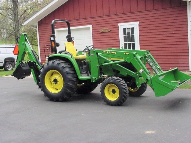

Jim,
I got a 4710 hydro, 460 loader, 72" HD bucket & 48 backhoe with an 18" bucket for less than your budget amount. I am very happy with the machine. The area I am in is hilly, rocky clay. The backhoe has worked great in those conditions.
I am not sure if this setup is still available. The new 4020 series looks like a nice replacement for the 4010 series.
Picture attached.
Chris

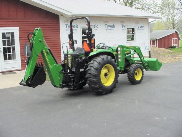

Rear veiw.
