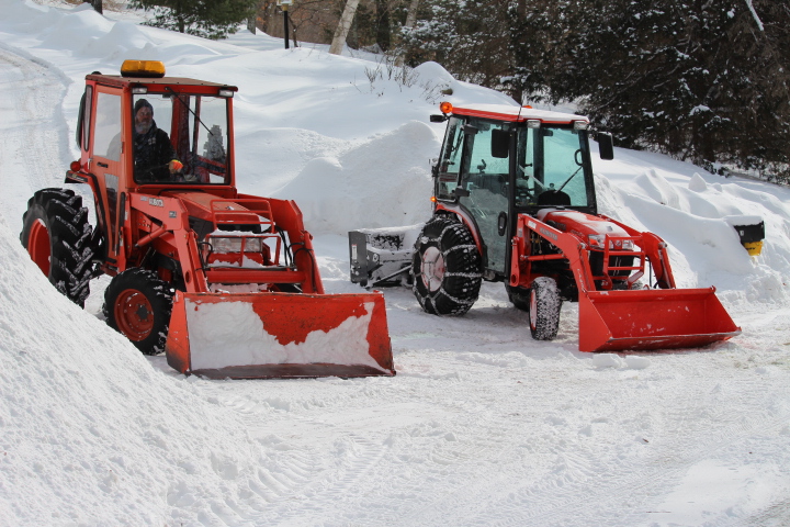

If I were you, I would go with an L. As you age, you will find that you will be relying on the tractor for more chores. And with 5 acres, you will be very busy. Here's a shot of my neighbor's L next to my B last winter. It's very doable around the yard.
