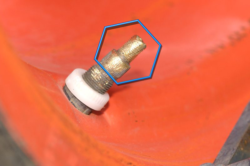

Here are a couple of picks of the problem:
Looking at the picture I realised that the valve inserts I got at TSC are not what I needed. As you can see the top part of the valve stem screws down over the base part. The one's I bought screw into the base piece.
So, I'm back to square one. If I could find the top part to this valve I think I could fix it but I don't even know where to look. Does anyone know if the valve stem in the picture has a specific name or type? I'll call the dealer on Monday and see what they can tell me.
Edit: From the pics the valve stem doesn't look terribly damaged but the end of the stem is squashed into an oval and won't accept a chuck or tire gauge.

The top part screws off from the base. Any shop that fixes tractor flats should have a new base ring as well as the top part of the valve. You may be able to chase the threads on the base. See if they have a brass nut instead of that plastic thing. The top screws apart here.

You guys are right. I was down at my place yesterday, mowing...yes on a Sunday (I did go to church by the way)...and I was able to loosen the top part a turn or two before any air started coming out. So the male threads on the base that mate with the female threads on the top piece are fine. So I should be able to go by a tire place and buy a new top part as suggested. I'll probably just buy the whole assembly (which is probably the only way they come) so I can replace the outer nut too.
My B-I-L suggested jacking it up, rotating the stem to 12 o'clock and removing the top vlave piece so I could take it with me to the tire store. I did not have time so if there are lots of different sizes I may have to buy a few of them to get the right one. But, even if there are different sizes, I'd think the top piece would be fairly uniform.

The TSC valve stems were the right kind. When I partially unscrewed the damaged one it looked like it had a female end. Well, of course it didn't. I even went to a tire place and they handed me ones just like the TSC ones. I told them mine were different. They looked at me like I was crazy.....which I'm not, just stupid. There's a difference...its better to be crazy.
In any case, I went down to my placed, jacked the tractor up planning to remove the stem end and take it somewhere to see if they had something like it. Of course, as soon as I got it off I realized it was just like the TSC ones I'd purchased. Screwed the new one in and pumped it back up. Good as new.
