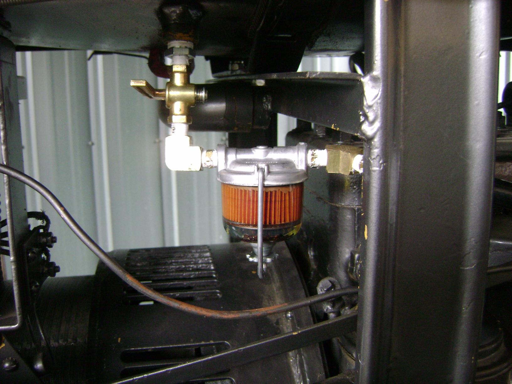

Arc weld. Just another thought may want to add fuel stabilizer before you store that welder again. All this ethanol is hard on older engines. Good luck.
   / It's alive but now another odd problem... #4
That's a very good point! I use additives in both my gas, and diesel farm tanks. I also shut the fuel off on all my welders, to let them die, before turning off the kill switch.

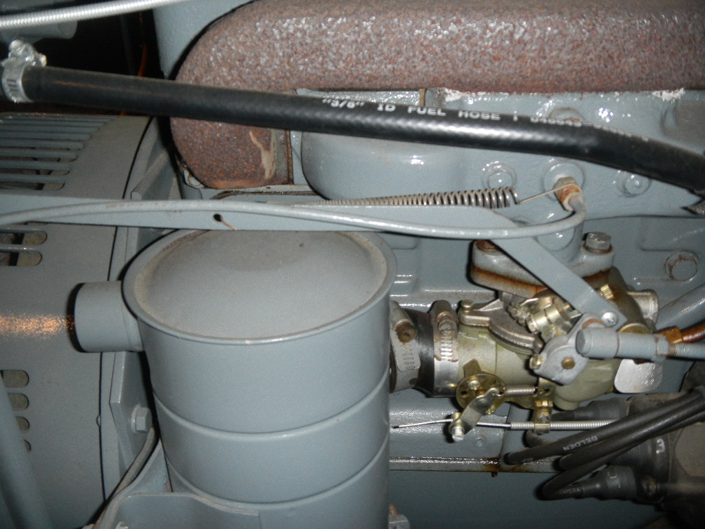

Just a thought! But I'm wondering if you don't have some binding in the linkage? Or the spring may be to old? Maybe couple squirts of WD40 on the pivot points of the linkage?
It seems to move freely. I think I just need to use it more.
