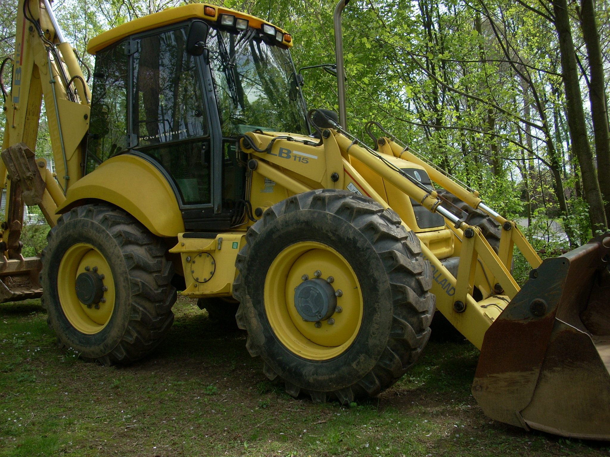

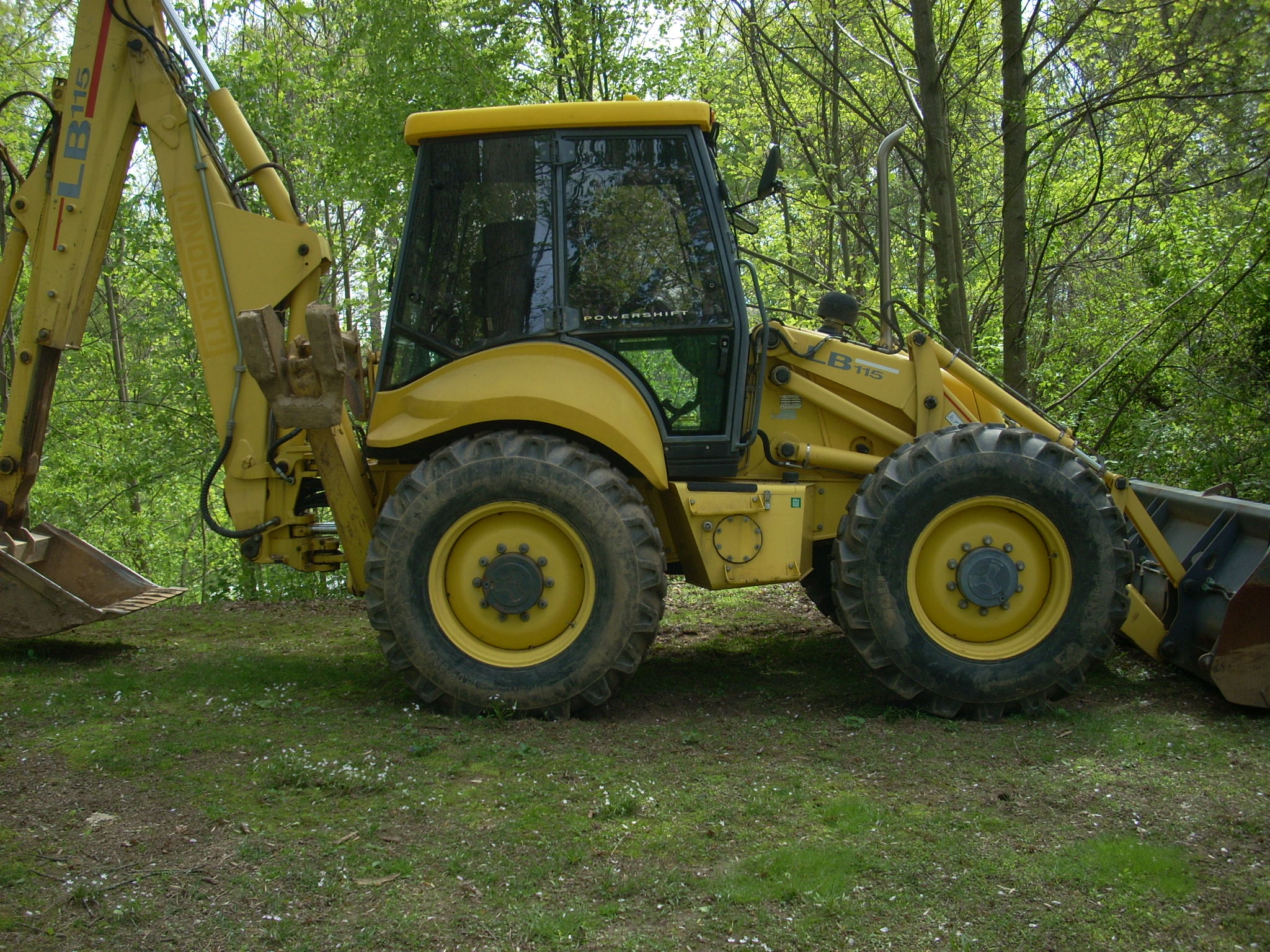

So ugly, it's cool.
You need my machine. 4WD, 4WS, posi front & rear axles, 26" ground clearance. Awesome in mud. Goes places even a mini-ex won't go....
