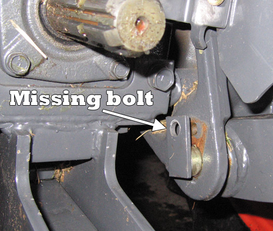

I changed the broken bolt today. Took 10 minutes. I wa moving some 2000# rocks around when it happened. I guess the pin was really loaded up with the weight and spun the bolt shearing it off. All fixed and ready to go again. Don't mind the real simple problems as this was the first I've had in the first 90 hours. Now my mind is at ease.

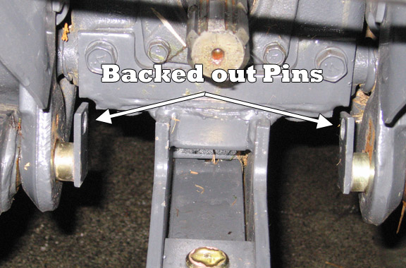

You are right on SteveA. A quick look around can sure save a lot of heartache down the road. I was greasing my tractor after the first couple of hours I had it and noticed the pins that hold the lower 3pt arms were backing out and almost falling off because the bolts had backed out (and disappeared). Luckily I caught it in time. Photo enclosed.
