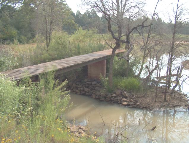

Finishing the Island is my next project.
The concept: was to build a bridge to the Island and put some kind of rustic structure on it with a roof and a stone or deck floor. I knew the trees would probably die but let them stay anyways.
The problem: all the old trees died and need to be removed. The Island needs to be raised about 2 feet. (The water rises to the bottom of the bridge and the Island goes underwater when the level of the water is at the spillway.)
I will be working with my tractor to fix the problems and will taking photos along the way. This will take about 6 months and I will keep posting photos with the progress.
This will be fun, and as always any suggestions or commits are welcomed. /forums/images/graemlins/smile.gif
The first pic is from the bridge side. Hand rails still need to be added.

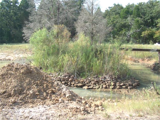

Photo taken from the dam. The water level is low.

This will be the side of the Island where I will attempt to access to add the fill dirt on top of the Island. I have already started to stock pile the dirt on the left side of the photo.

So I guess you are going to first build a bridge for the tractor to the island by piling dirt into the pond at the shortest point between the shore and the island?

Neat, and sounds like fun the only suggestion I might offer is use rock/stone/etc instead of the dirt you have there as the dirt will absorb the water and forever get worse and worse to traverse to your Island, If rock and etc is avail I would use it and it can be removed with your backhoe and be used as a buttress for your bridge pilings!!
looks great and fun to boot!

What did you use to span that long of a distance?? I am looking to do the same thing but I am trying to figure out what to use....
   / Island Project
Nilesw, the beams used for the long span are about 100 years old and were first used in a old train depot, then an old farm house and finally the bridge. To get the beams from under the old house I had to take the house apart board by board. I used the wood for my barn and will use some more of it on the Island. I would not do it again - too much labor involved. The long part of the bridge has three of the beams and is 20 feet long and 4 feet wide. The second part, on the Island, is about 12 feet long. The bridge decking is treated 2X6s.
For the bridge pilings I first poured a slab 1 1/2 times the footprint of the piling. Then I put re-barb in cinder blocks, drilled holes in the sides of the cinder blocks for more re-barb and filled them with cement. When I got to the top I left some of the re-barb exposed to connect the beams. I put a slight slope on the top cinder block and then tar-paper and then the beams so moister would not collect at the contact area.
