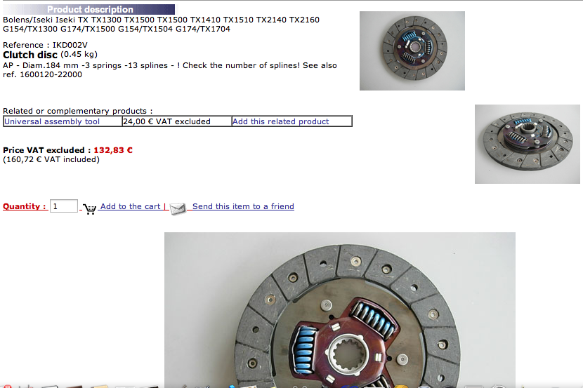

Hi everyone
I am in the cluch replacement phase of my iseki tx 2140f. Year 1981ish. The tractor has the 3 cyl. k3a engine. In my part manual the clutch disc is named 1427-120-2500-0. On net i find the clutchdisc with 13 or 18 splines, both 184mm dia. Does anyone know the correct disc for my little lady?
OJ
   / Iseki tx2140f clutch confusion
#2

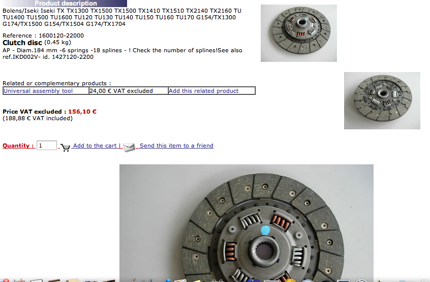

the 13 and 18 splines are both for iseki tx2140 in these 2 pictures from a webshop. I called a dealer today, but he did not know how many splines his original kit had. He also told me there where 2 types, but did not know how to tell them apart, one was most common. I had to open up to see.
I bought 2 clutchdiscs from US. They have both 18 splines, so maybe i have 2 discs that fits - or none :confused3:
Can anyone please tell the difference
best regards - The clutchcollector
   / Iseki tx2140f clutch confusion #3
OJ,
I dont know if this will help but heres a little more information for you. I have a 1990 Bolens G152 Which shares the same parts manual as the TX2140T. Its just a re badged tractor. The parts manual shows the part number you are refering to. As to your question about 13 or 18 splines, If you look up under your tractor just behind the clutch and prior to the transmission you'll see an opening which you can see the drive shaft. you should be able to count the splines on the opposite end of the drive shaft where it connects to the rear end. Mine shows 18 splines. I'm thinking that it would have the same number of splines on the clutch end also. Just guessing though.

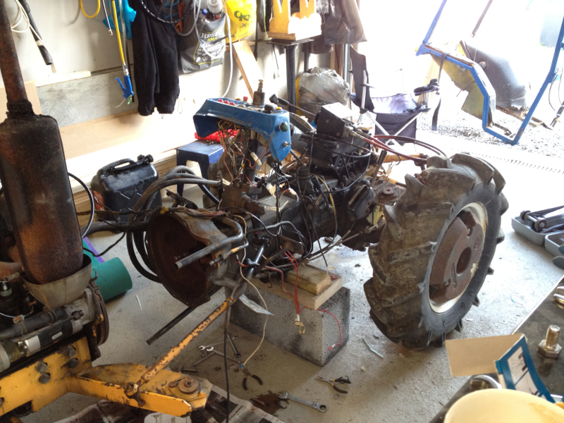

Its done
And the number of spline is ------- 18
Yessss, it all work out perfect :)
It is a fantastic piece of macinery to work on. Love my little lady
Well thats it folks

Thanks, it was good to work on it. No bolts stuck - or breaking - except on clutch cover. Beware - do not use ti much force.
I could not find the opening to see the other end. Will look today. Could be good to know. Still want to understand the thing about 13 and 18 splines.
Have tried to sum up my ecperience in a new thread with pictures
