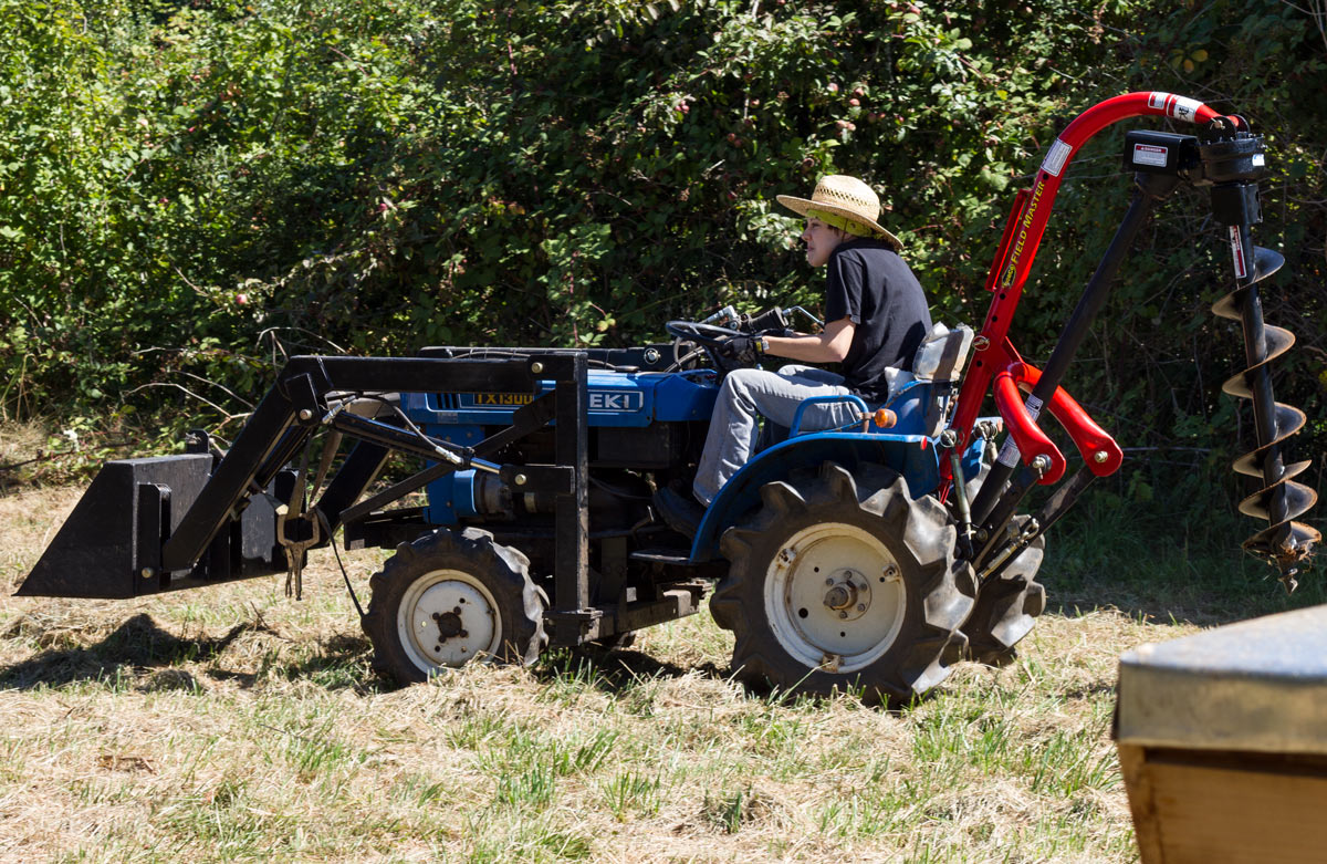

]NICE! So there's another PTO? It's late so I don't want to go out and look. Our TX runs a 4ft brush hog, a tiller (the original Iseki one), and we have a hole digger. I need new tires but priorities are elsewhere at the moment. Tomorrow I'm going to install a Zena 150a welder so we can do some fencing. Someday I'll restore it. I fell in love with it because it's so small and so **** tough. I rebuild TDI cars for a hobby and all my equipment/cars/etc are diesel powered. I'm new to tractors and I'm glad I'm around to learn something new about my TX. Here's my wife acting silly on ours.

Thats a great looking TX! At least your wife will drive it, mine won't. I think that it intimidates her a bit, yet she will drive our 4 wheeler around the property all day long. Did your tractor come with the loader, or did you add it later? It looks like the ones that I was looking at in Washington. I really need a loader, but they are big money. We bought our tractor for the same reason.. Perfect small size, and I agree 100% They are built like tanks. I have a Post Hole Digger, a 3 point wood splitter, a rear dirts scoop, a single plow, a carry all, a lift all, a trailer for ours. I use it almost every day in the summer, and every week in the winter on our small farm.
The front PTO might be a bit difficult to get to with the loader on, but it is behind a small panel under your radiator. It is run by the fan, but can easily power a PTO pump. You have the original rice paddy tires. They are pretty impressive! This is my first diesel, and now, I wish everything I owned was diesel.. Thanks for the photo! Below is mine with the post hole digger, and the location of the panel. I know a ton of places to get parts if you need any, and I know where they sell the TX decals if you decide to restore it someday. Most of the parts are very inexpensive. The PTO pump is one of the most expensive parts unfortunately.
   / Iseki Tx1300 Hydraulic woes
I bought this from Coldwater Tractors in Washington. They've got quite a bit of old tractor imports sitting in the weeds. The loader was made for a TX1500 and they installed it. That panel is still accessible with the loader on, I might pop it off tomorrow and see if I can make a removable Zena welder bracket for it. Immediate needs on it include tie rod ends (ball joints) and tires. I really need to find tie rod ends however. I was thinking about cutting them off and welding on some VW type ends.
