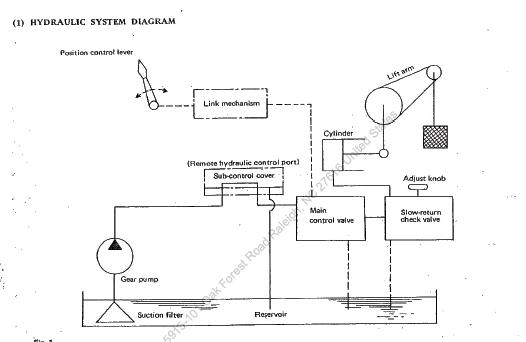

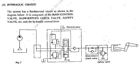

I just bought this tractor,:) and can not find a manual for this model!:confused: How can I tell what year the tractor is? It is a standard transmission and someone told me that the hydraulics shared the same oil as transmission. Need a drawing of hydraulics also as 3 point hitch will not operate. Can anyone please help me? PLEASE HELP

The hydraulics share a common resovior with the transmission. Uses 80w gear oil. I have a manual in pdf format but it's too large to email or post. I'll try to post the pics you need.
attachment.php
attachment.php

Thanks Joe just saved my day! Wish I could get that copy of manual in pdf format, as that would come in handy. Is there a filter for tranny/hydraulics? Have not located one yet. Thanks again for the help.
