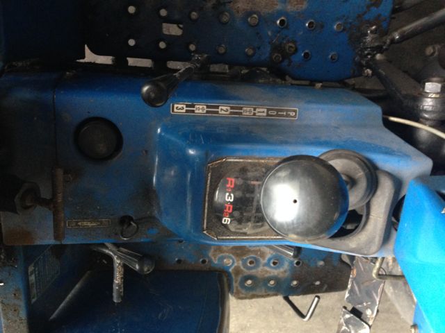

Hi
thanks very much for getting back to me.
I rather suspect it might be somehow disconnected or that it has failed.
I'm not sure that the PTO speed selector has a "neutral" setting. At present, it is possible to spin it clockwise and counter-clockwise whatever else is happening, whether the engine is running or not, and whatever speed setting you have selected. This is what is making me think that there should be a control to engage it or that it is broken.
I have attached a pic of the speed selector switch. There doesn't seem to be a 'neutral' marked.
Thanks
Phil
   / Iseki TU1700F - PTO Help #4
On my TX1300, there are neutral settings between 1 and 2 and 2 and 3. I can't tell from your picture but yours looks similar. Yes, you probably have some sort of gear box issue if it doesn't engage in any lever setting. Check to make sure the lever is actually rotating the shaft going into the gearbox when you use it (if yours is set up that way, mine is). If it is then you'll probably have to open up the case to troubleshoot and repair it. Not something every tractor owner is thrilled about having to do but it's not the end of the world.

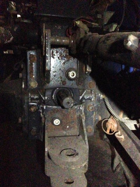

Thanks, that was very helpful. I have checked those two things out:
1) There is a definite neutral, and in fact with the engine running, gearbox in neutral, if I slide the lever from the neutral between PTO speed position 2 and 3 back towards position 3, I can hear the cogs trying to mesh. If I pop the clutch in, of course it slides in fine. This would seem to indicate that the lever is doing something and the gearbox end of the thing is okay?
2) In order to look at the PTO shaft end, as suggested, I would need to remove the cover around the PTO shaft, which is bolted on. To get at these bolts I would need to remove the top link mounting plate at the top, and the tow hitch mounting plate below. I had a quick go at this, but the first bolt I removed caused a hydraulic fluid leak... Can I get in at this without losing my hydraulic fluid?
To be honest, if I had to drain it down, it wouldn't be the end of the world. I have bought the filters and oil to do a full service anyway. I am just a little nervous about draining the gearbox/hydraulic fluid as I have never done it before. Will it all need bled when I fill it back up? I'm only really familiar with changing engine oil, which I suspect is much simpler.
Thanks for your help everyone, I feel like I am making progress.
   / Iseki TU1700F - PTO Help #7
Sounds like you'll need to go in and see why the output shaft isn't turning. Changing the hydraulic/transmission oil is almost as easy as engine oil. You won't need to bleed anything but you may have to run it for a few minutes after filling to have it self-purge the air which, most of the time, you never really notice happens. The only thing that could be considered a little hard is removing the pickup screen and cleaning it. This is found in the line feeding the pump (the bigger one) in the transmission housing. You'll usually notice at least some metal shavings when you pull the hydraulic/transmission oil screen. I'd recommend using one of those telescoping magnetic pickup tools to go in after you pull the screen to pick up as many remaining shavings as you can. You certainly don't need to do this but the more you can remove while you're at it the longer you can run until the next cleaning.
