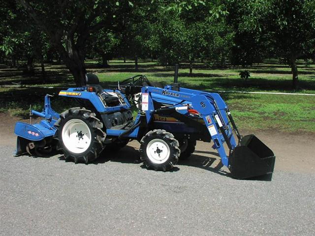

The web site shows that you can pay extra and get a Koyker 80 loader. I am almost willing to pay the money just to see that. I have put quite a few loaders on the TU models and down to a 170 it is workable but below that you run into big problems. The front axel on the 160's and below are so close to the floor board the only option you have is to go outside of the floor and back. So you have a tractor 48" wide and this big wide loader that sticks out wider than your tractor. It looks really dumb and is somewhat unstable compared with a narrower mount. A Koyker 80 mount is narrower than the floorboard so to make it work it must be a SUPER custom fab job. If you do get it with the Koyker pleeeeease send me a photo.
The TUxxx models also have a problem with a rear bias front axel making it hard to get the bucket close to the front tires. When I mount a loader my goal is to get the bucket as close to the front wheels as possible to minimize leverage. Take a look at the pic of any TUxxx and you can see getting a bucket close to the axel is difficult.

Well said. We have installed Koyker loaders on a TU200F (hard to do), on a TU180F (maybe even harder) and a TU150F. I'll never do a TU150F loader fabrication job again. Very difficult, we probably spent 3 days on it. I'll email you the pictures. Great little tractor, not well suited for a loader for just the reasons stated.
   / Iseki TU150 - any loaders fit this guy? #10
Here is one picture of an 80 on a TU150F. Don't try this at home /forums/images/graemlins/wink.gif
