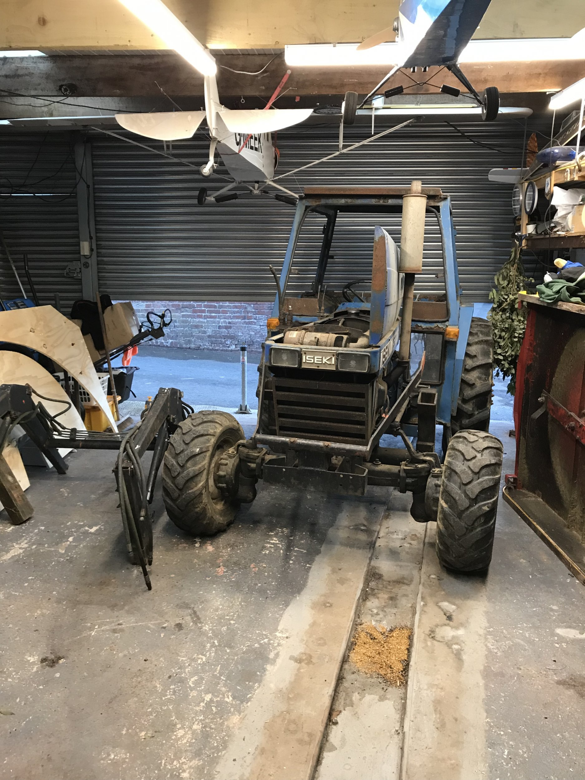

Hi All
I’m struggling with my iseki 3110. I have no power steering or any hydraulics. Does anyone have a diagram for the hydraulics or know much about these machines? It seems that what I would of thought is the power steering pump on the front of the engine is plumbed into a flow diverter for the loader aswell as pressure and suction from the back end? I’m not quite sure where to start looking really?
thanks all

Many tractors have a hydraulic pump at the front of the engine driven by a gear on the crankshaft. They are frequently a gear type pump and rarely fail. You could try making sure you get return flow to this pump then put a pressure gauge somewhere on the pressure side to get an idea what's happening. You could have a clogged screen on the suction side but I have no idea where that would be.

Thankyou! I’ve now chased back the pipe and I’m not getting barely any suction out of the back end, can I just blow down the suction pipe and see if it’s blocked?
   / Iseki TS 3110
I have further chased it and sound I have no suction from the back end? Oil level is correct but when I suck on the pipe it’s just air and no oil! Anyone got a back end diagram?
