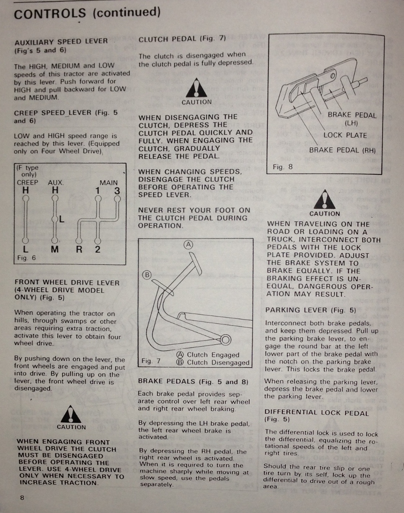

I have an operator manual that shows only for the 4x4 a three speed transmission with three forwards and a reverse, a H-M-L lever, an a H-L lever. That would be 18 forward speeds. And the two wheel drive does not have the H-L (creep speed) so 9 speeds.

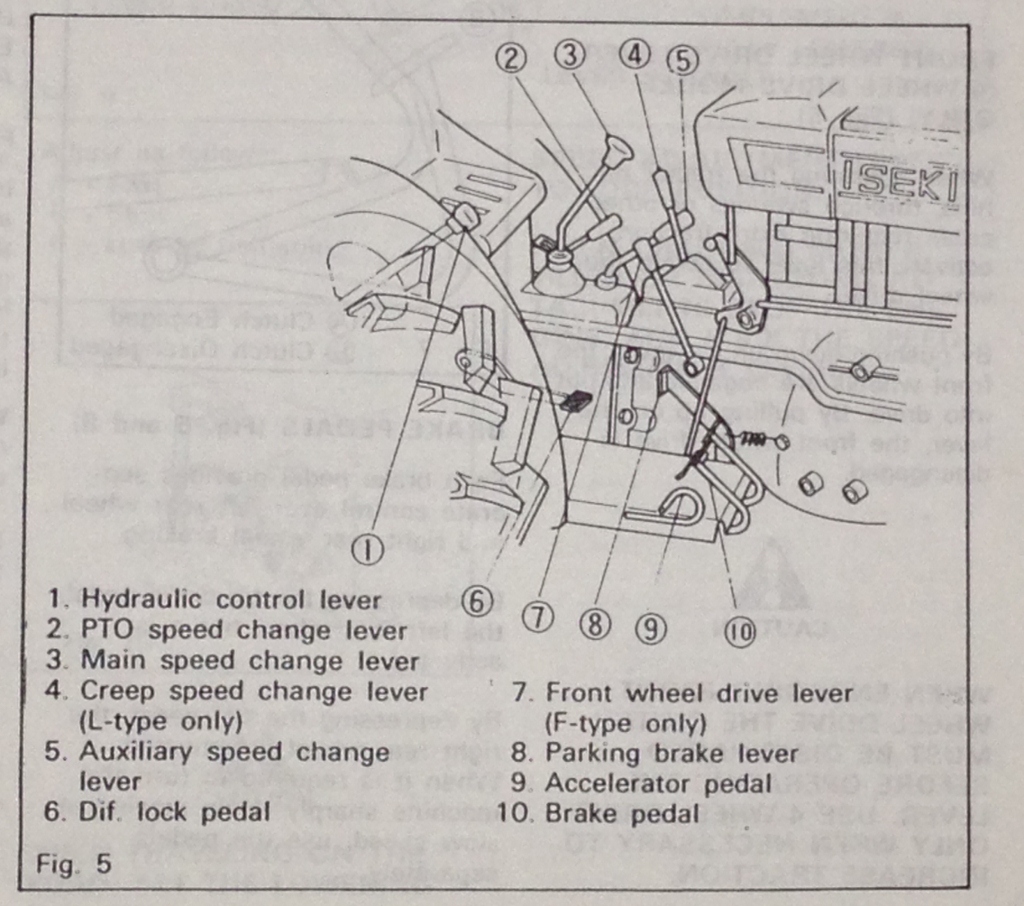

Attachments with some information on the TS1610/1910 controls.

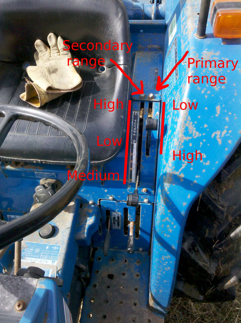

Here are the settings on my TL1900:
Speed range, primary and secondary:
