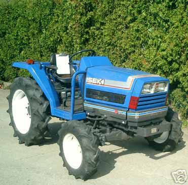

Does anyone have any info on this tractor? (Iseki TA262F). Any known problems. Parts availabilty problems? Does it cross to any Massey tractors? I was told any loader that would fit the MF 1240 would fit this.
A local yard has one and says it has power steering, shuttle shift and low hours. I'm going to test ride it Monday and thought if someone on here knew of any systemic problems with this model or series I could check those first to see if I should even look at it anymore.
I think the TA series is a lot newer than the others that are real popular (TS & TU) that is why I'm concerned about parts availabilty and whether it has a direct US model cross or not. I've been looking at the Yanmars for some time now but I haven't been able to move on one yet then this popped up the other day just up the road from me.
Thanks in advance for any help.

I have had a TA262 also TA 215,TA270 and a TA 207 I now use myself. I have been dealing in greys for 5-6 years. This is my pick of the litter. It is weird about the Massey cross. There are several models 95% direct cross but non exact. I put a loader on a TA 270. I had to order body mounts from Massey off a 1250 to make it fit. So far anything I have needed , parts wise, I got from Jack's Small Engines. I have Massey and Iseki manuals and research them to figure out which one I need to get the part from. It is funny. I just got a Kubota. It is much easier to get filters etc. for my Iseki than a Kubota. If it is a solid tractor , you won't be sorry.
I attached a picture of mine. The grill is the only thing different than the one you are looking at.

TA Isekis are very nice, repair parts are available and depending on the part they can be extremely expensive. The chassis is the basis for a lot of tractors not just Massey. Mahindra and TYM also share a large part of this design.
I'm guessing this is the TA that is on EBAY #7583585211? If it is the dealer is showing it at 35 horsepower. Not even close to the correct hp. I looked at the rest of his equipment and not one tractor horsepower rating was correct. I would be worried about buying from a dealer that is so misinformed about the product. Some dealers add 3 hp to PTO for flywheel and some add 4 but never 8 to 12.
