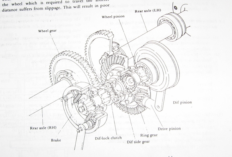

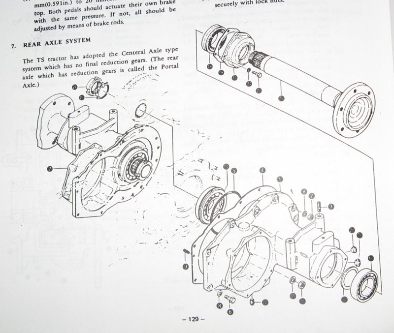

does anyone know how i can pull out the rear LH axle shaft from the tractor. i have all the bolts off and the cover is loose but wont pull out. i need to replace the outer axle seal. the local shop wants $800.00 to do it for me. i AM mechanical inclined to do this. oh its a iseki TS1610 model. was told its the same as a bolens G194!!

On the TS1610 looks like the axle shaft passes through a gear inside the tractor. On inner side of the gear there is a nut on the end of the axle that holds the shaft in place onto the gear. So you will need to get deep into the housing under the seat. I can post more later.
Attached views from my tractor manual show the rear axle.
