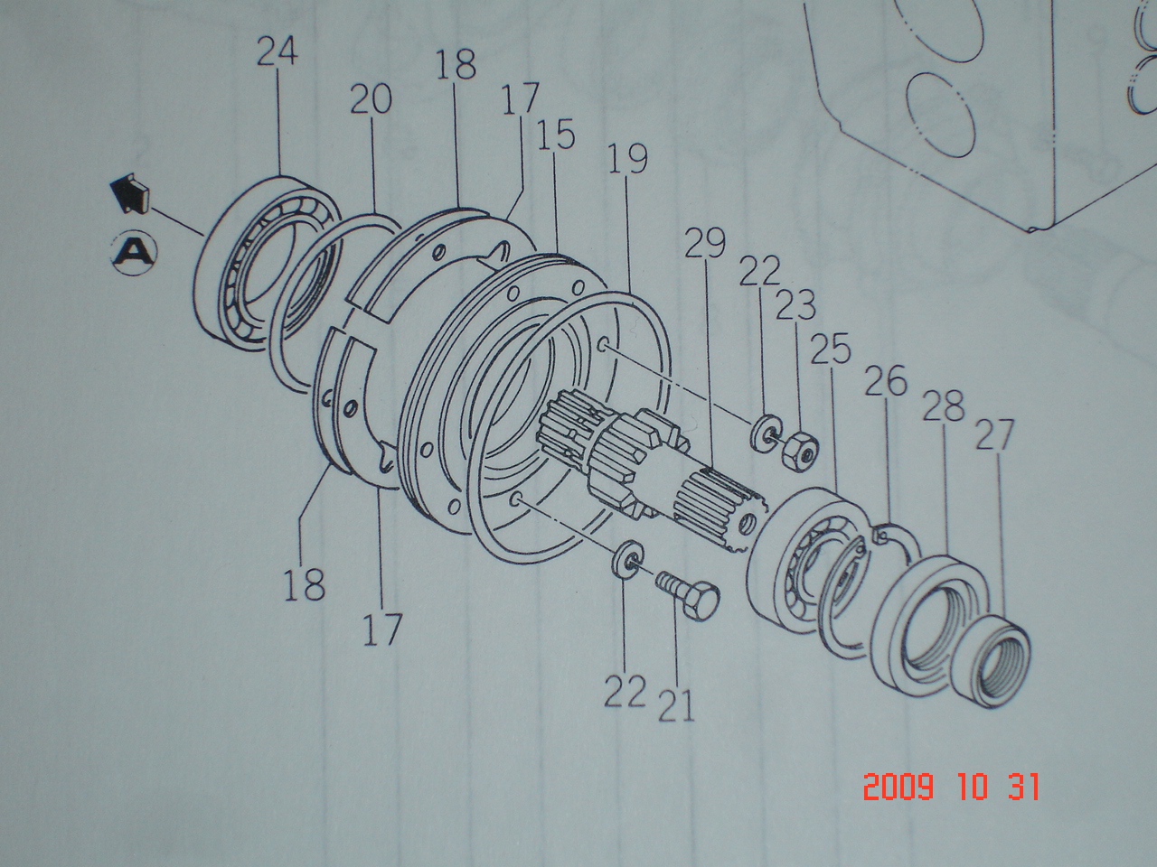

i have a ts 1910 i need the seal that goes behind the left brake drum and what weight oil goes in trans/rear ?
   / Iseki Parts PLEASE #8
The parts manual lists this lip oil seal as a metric size 45/72/12 (ID/OD/width). You can pick one of these up from a local bearing supply house or on-line from a supplier like Rocket Seals (see link below):
Metric Oil Seal 45mm-54mm Internal Diameter at Rocket Seals
There's also a smaller "bush seal" shown on the parts breakdown at the end of the wheel pinion (next to the oil seal) with no size given. That could be a special Iseki part, hopefully one you don't need. The bush seal is item #27 and the oil seal is #28 in photo below.

thanks for the info,what weight oil?

did this come from a service manual or a parts manual
