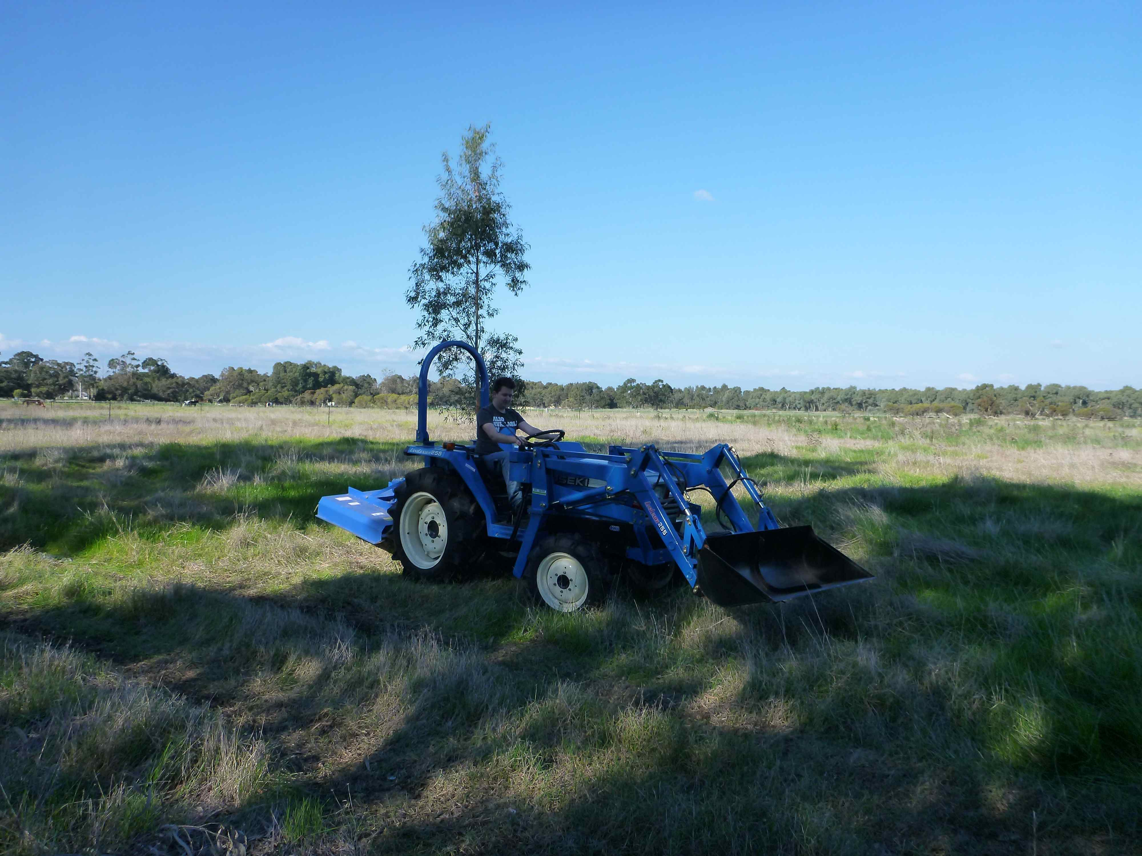

Gday fellow forum members,
I have just bought a second hand Iseki TA 255 tractor. Great machine. Is there anyone who can tell me where to get service and operating manuals? I am in Australia. I also have a fancy electronics box on the tractor that controls the 3PL on the rear. Anyone have advice on how this works? I can raise and lower my 3pl, but it is not level. TA 255.jpg
   / Iseki LandLeader TA 255 tractor #2
Hi JungleJon,
I have a TA270 which has a similar box on the right side bumper. In my case the only option that works is the toggle switch. This operates an hydraulic cylinder on one of the 3TP linkages. Cant remember which way is which so try and see what happens. You do need to have the tractor running and in my case ignition on (electrically actuated cylinder).
If the toggle switch is not working there is another knob that has i think 3 preset positions one of these corresponds to manual control, which is the toggle switch.
Hope this will help
Hi Grich,
Thanks for the info. I think my electronic box all works? Although I was old it was disconnected. I will follow your advice.
