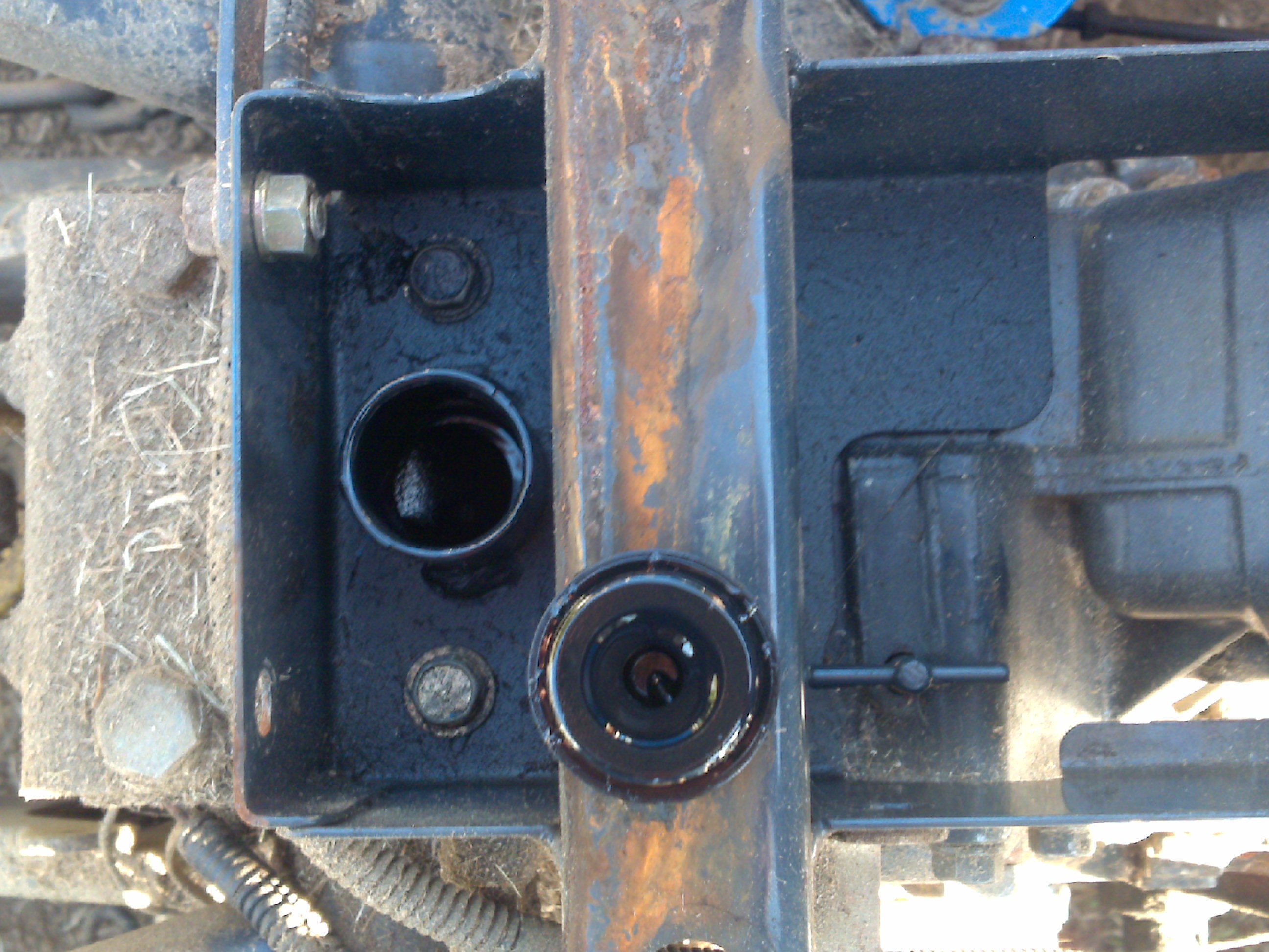

Hello all I'm new to these tractor thingies and I have inherited my fathers old Iseki 2160. Now when you lift up the seat there is a rubber stopper on top of an oil reservoir but no indication of whether to put in hydraulic fluid or gear oil.
If one of you wise men can point me in the right direction it would be very much appreciated.

There was two pots of oil that were with it other than normal diesel oil. BP hypergear 85w-140 and Mobil gear oil heavy duty 90w
I was also wondering whether you just top it up as there seems to be no level indicator?

Hi.
I don't think you should use gear oil. The manual specifies "Agricastrol MP 10W/30" or Shell Donax TD.
If you send me your email, I can send you the page of the manual.
