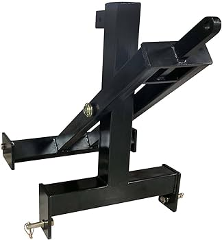

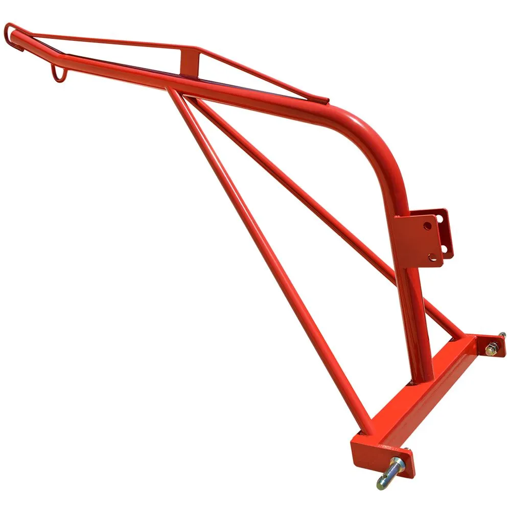

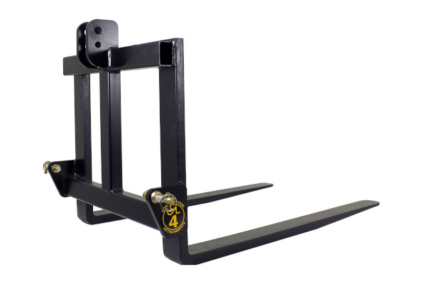

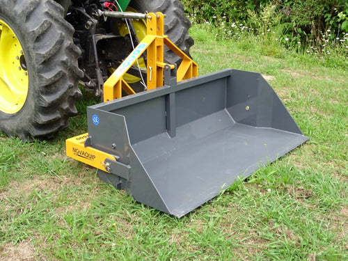

Alternatively you can look at 3pt implements that will do 90+% of what a loader will do:
Boom pole, 3pt forks, 3pt scissor lift, 3pt bucket, etc.
