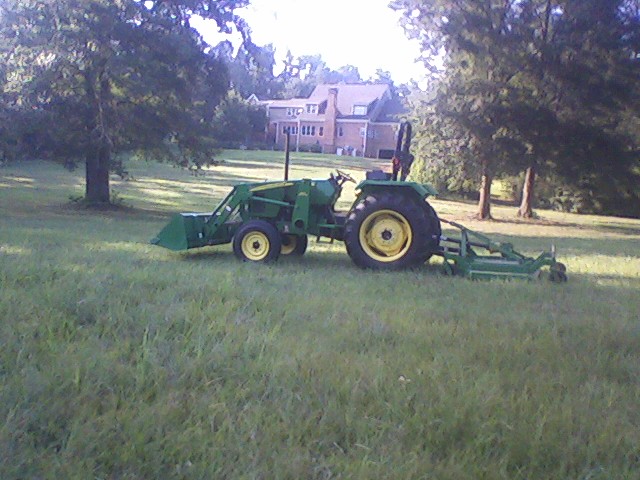

Condition is a good factor along with size. IMO. if it's Mech. it's usually repairable but it's real hard to overcome power. For Ex. I use a 5103 JD. a few miles from my Hm. With FEL. FM. BH. BB. and it has never Hit my Hm. of 11acres. That is why I never thought of giving up my YM2000 to go to a larger unit. The only thing the 2000 doesn't have is a FEL. which I purchased a Rear Scoop for it. Which has worked better than I expected. The JD. wouldn't be able to even move hardly in my woods of about 8 acres. Even with the quick disconnect FEL.. Now if I would clear the land it would be a different story so to speak. And then the other way 35acre 17 of BH. 8FT. Squealer and the other 17 a 8Ft. Masio FM. is just to much for the Yanmar to try and keep up with. And just pulled the Receipt for my repair of the Org. Rear tires on the 2000. I had to repair them from cracking and splitting. The inserts have worked so much better than expected. Been just a little over a Yr. with out the first bit of trouble. :thumbsup:
