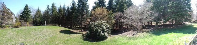

I bought a fixer upper in Essex MA on 2.5 acres of mostly flat land. It is a great piece of land that hasn't been maintained for many years. On top of that we have plans to make improvements which include the addition of a pool and a barn. I'm a big DIY person, and being in MA, hiring anything out is generally very expensive. Below are the some of the tasks I intend on tackling in the next 5 years.
1) Some idiot decided several years ago to plant about 40 spruce trees. Now in 2013, those trees are 30 feet tall and growing into each other. They look like ****. Not to mention that they have over taken several apple, peach, and pear trees on the property. These trees average 14-16" trunks. I plan to cut them all down, mulch what I can, and possibly use the straight ones for lumber to construct a timber-framed barn.

I'm attaching a few shots of the the spruce trees that need to go...
Any input would be greatly appreciated!

You have my sympathies on the spruce. At least the lower branches have been trimmed up and that helps a lot if you start chipping them. But, after that, would you need a chipper? That would be a lot of material to put through a small chipper/shredder, and it will take time to chip it with 4"-6" PTO powered unit too, but they would handle it easily.
If the 20x40 in-ground pool is going to be at all deep, like 6', that will be difficult to dig with just a loader. Not impossible, but not easy either. What are your chances of not hitting any sizable rocks or ledge? It looks like your septic is a raised mound type, that may be due to what is below it. You don't want to drive a tractor of any size on a septic mound by the way.
