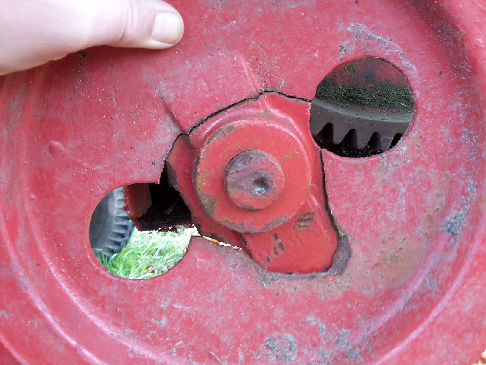

Hi all,

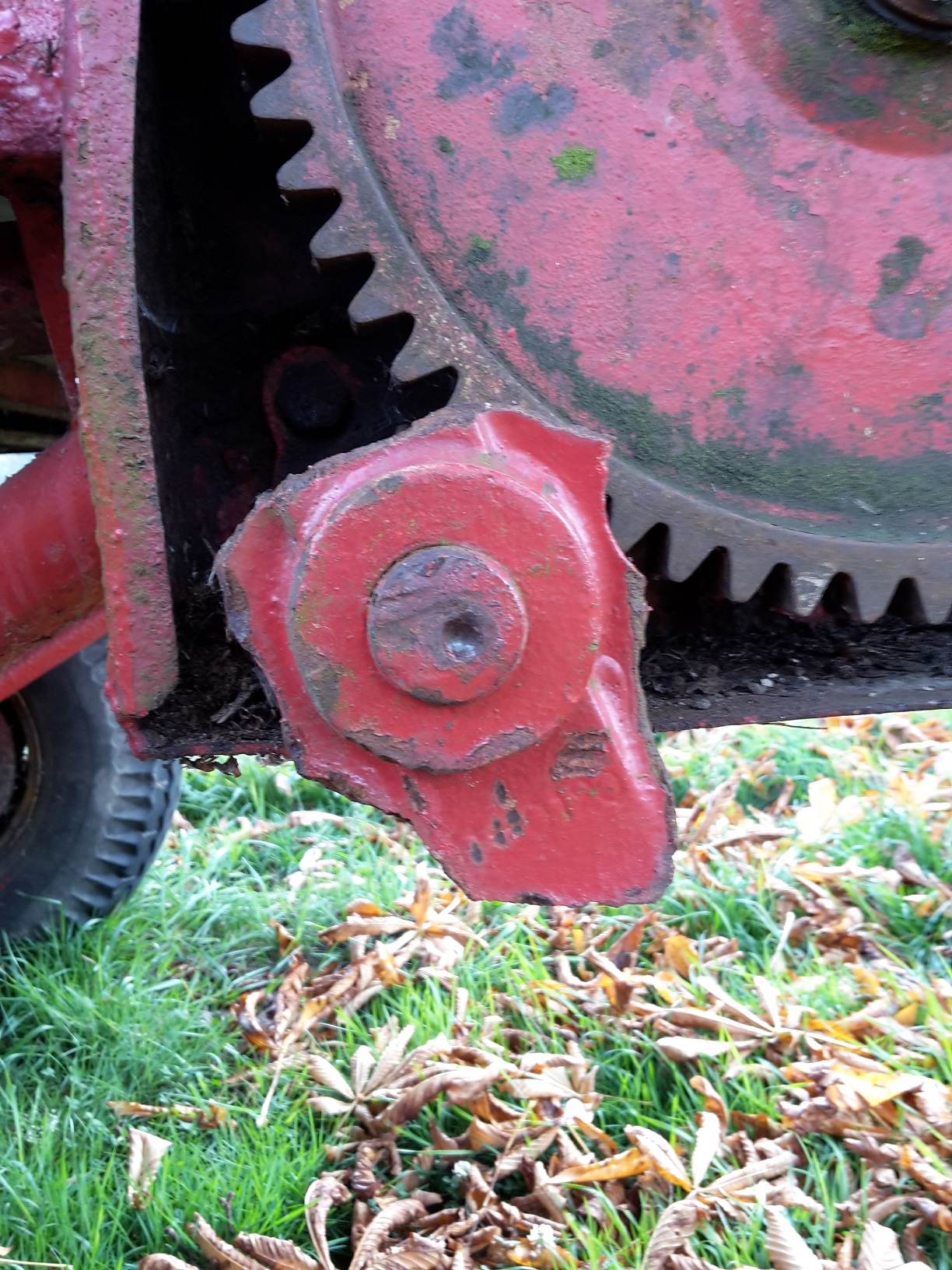

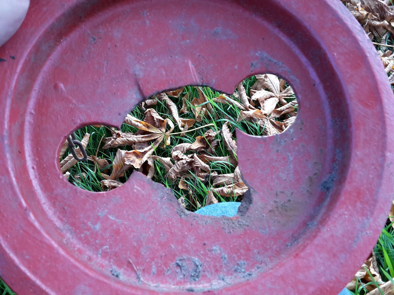

On my latest "score" I have 1 defect (for now). The previous owner bumped of one of the pullies which are needed for driving the rotation breaker. It is an old JF manure spreader, rear discharge.
A new pullie is hard to find, and would probably cost a lot. Separate parts even harder to find. So I was thinking of welding it back together ...
It probably is cast iron by the looks of it.
What do you guys think ?

That's exactly how to do it. Preheat, cool slowly. Slow cooling is just as important as the preheat.
Get the hub off the shaft, and clamp the hub and sheave pieces to a flat plate so the welded assembly is true.

As long as it doesn't have to be perfectly round or balanced, Weld it. It will be difficult to get it perfect and it will likely not spin 100% true. I'd at least visit a belt and bearing house and see if you can get an aftermarket pulley. There are millions to choose from. Might not be an OEM but I bet you could find a new one pretty reasonable. They can get a blank pulley and put in keyway or setscrews or bore larger etc. I have friends in that business and they sell a crap load of these.

If welding doesn't work, clean up the break on the pulley, leaving a flange inside as large as possible. Bolt a circular steel plate inside the old pulley, with a new hub to fit the shaft.
