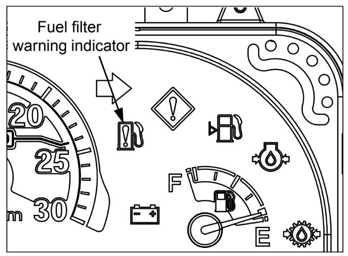

I filled it with diesel from a can I filled 6-8 months ago. The can has sat under the lean-to next to the tractor all "winter," out of the elements but no indoors. It may or may not have been sealed well, not sure.
I was running it for 30 min, then filled it, then ran it 30 more minutes, did not experience any issue. Then I parked it for maybe 3 hrs, and when I started it back up, that's what it was doing. Once up around 2500 rpm the issue went away and after the engine was warm it would run fine at lower RPMs as well.

That tractor does have a water sensor. It will (well, should) throw a dash light.
I think something else may be going on here. However, drain a bit of fuel from the filter, see if it has water in it.
If no water is present, I'm thinking a clogged injector... maybe. One cylinder is not firing all the time. But a clogged injector will also throw a code. Anything with the ECU, should throw a code.
Do you have a reader?
And it goes away when warm or at high RPM... leaning toward partially clogged injector or water in the fuel. The high RPM, the more pressure, the more fuel, the smoother it runs. The lower RPM, the lower the pressure the less fuel.
But check for water first.
